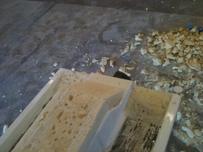

Day 3
So today I shaved all the foam to shape there are a few stops that still need a little bit more foam. For the most part I am about ready to start glassing over every thing.

Vumad
Super Hero, with a cape!
St. Pete, FL
Be careful with your seat area. You cut out the lip on the side. You might not be able to fit the stock seat on if you glass the way it looks like you have the foam.
Also, did you remove the fiberglass under the seat? There's a white line that looks like you didn't remove all the glass? Not sure what you did as I can't see under the foam, but what I'm getting at is that if you are going to do that under the seat remove all the old glass because it's heavier than the foam.
Is that PVC a scupper or your exhaust? You can use PVC for exhaust, but it's much better to use aluminum or stainless. However unlikely, it is possible a backfire in the exhaust could crack or otherwise damage the PVC.
Styling looks nice.
