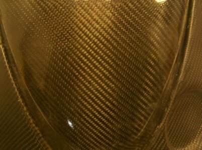

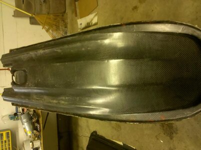

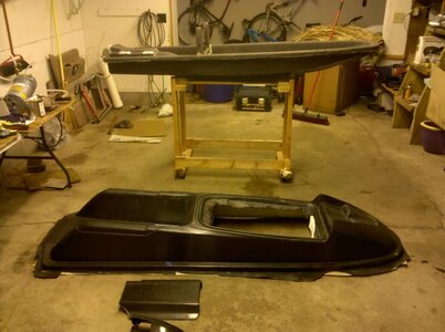

I picked up this hull this morning. I cannot take any credit for the work you see in post #1. Previous owner has had his SJ moulds advertised on here before. I believe hull is the only attempt at a complete layup. Bottom deck is solid and could be considered done if I didn't want to cut it up. Top deck & hood need additional layers of material.
As with my BOB build last winter, I'm going into this pretty blind. I've had a little composites experience in school but haven't worked with it since. It will definitely be a learning experience and I hope i have the patience to get through it.

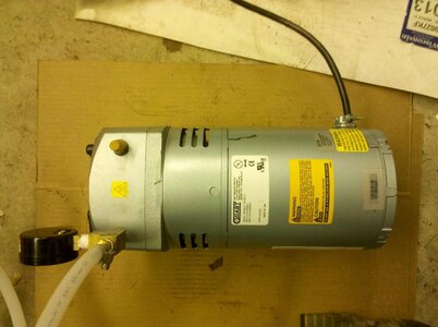

I've been tossing around a few ideas on what i wanted to do for a ski next year. I knew I wanted to be back on a lighter hull and was able to make a deal on this hull, a vacuum pump and all the left over materials he had.
Plans:
Shortened rear
Shortened nose with additional rocker
Bond rail mod
Lowered hood
Wide tray with adjustable holds
If I get through that, maybe consider a pump tunnel mod and widened bottom deck but I don't expect to get to these two.

Honestly I would glue that thing together and run it as is, strong and light. Buy a stock hull to chop up then use those materials to build a mold off that (if you so desire).
I thought about just doing this as well.

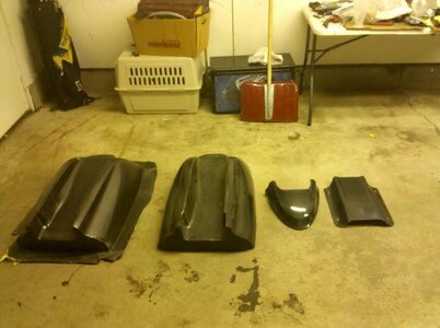

For sure I'm going to do the mods to the rear and tray area. the top deck is nowhere close to being ready to run, so why not cut it up now and reinforce it after? Same goes for the hood, and I got two carbon hoods with it. One layup the pump failed to it's a perfect candidate for a lowered hood mock-up.
As far as cutting up a stock hull. I thought about doing that to my 07 hull, but I have about the same amount of $$ into either hull. I can sell the 07 and come out basically even. Why start with something that is 60+lbs heavier? If i'm going to go through to trouble and spend the time to take on a build like this, I don't want the finished "plug" to be that much heavier than an actual layup of the hull if it's gets to the point of splashing molds off of it. I'm hoping to end up with a ski that handles well, is strong, and still pretty light. At this point I don't really have any intention of creating molds and making more hulls.
I'm not going to dive straight into to hacking the whole thing up. I'll start with some of the easier work and see how it goes. If I enjoy it and think the work is coming out well, I'll continue to mod. I have all winter to build. I need something to keep me busy :woot:

I would be nervous to take (what seems like) a solid hull with nice carbon work, chop and patch and not have adequate construction or adhesion and end up with 3/4s of a nice carbon hull. I think that the light weight of the hull will have a more desirable ride than whatever you think chopping the nose up will. Your OEM hull may have cost the same but it is definitely not worth the same.

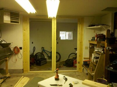

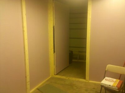

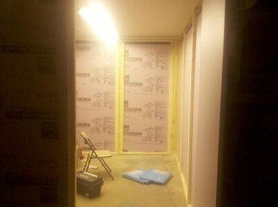

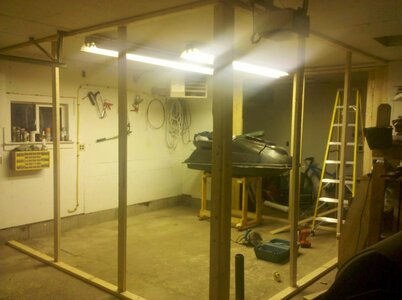

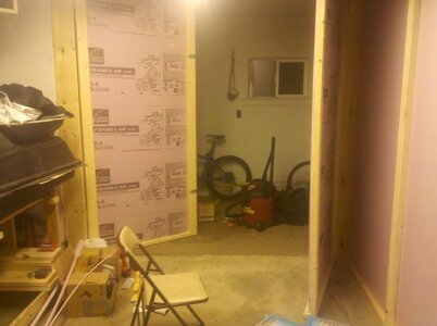

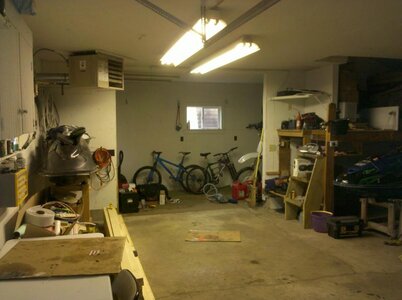

I starting building a 12x12' enclosure in my garage around the furnace so I will be able to work through the winter and have a place warm enough for the resin to cure. This was a fun project because it was the first time I've had a place to build something like this for myself.

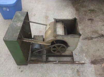

I scored an old furnace blower on CL for $5. I plan on using this to pull an airflow through the room and exhaust it out the back side of my garage. I will use furnace filters to filter the in coming air and plan on using a 4" HVAC filter on the exhaust air.

Nice set up man! The heater you have hanging from the ceiling,l've been looking at those for my garage.l think that would do the job (maybe too much) cause l only have 850 sq ft.Hmmmmm
Tommygunz
Team PHP
Wisconsin
Looks pretty bad a$$ man! Boy the hull and the new hot shop. Looks like you have a long winter ahead of you.......keep me posted on progress :)

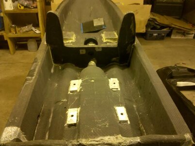

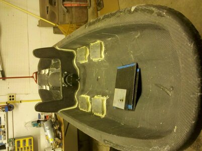

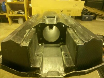

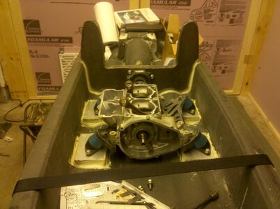

Started mocking up the drive train on this yesterday.
When I bought the hull, the pump inserts were in, pump shoe mounted, Bulk head in, midshaft inserts in & motor mount plates in.

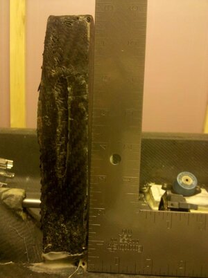

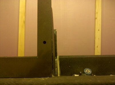

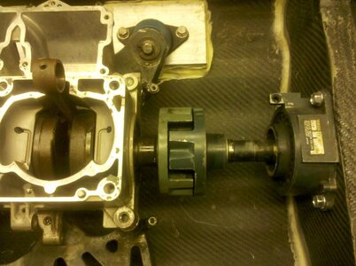

I'll start with the bulk head. Is this supposed to be square to the top of the bond rail? This one is tilted towards the back of the ski slightly. I'm having alignment issues between the driveshaft & midshaft. For starters, the midshaft was mounted about 3/16" off center towards the starboard side of the ski so I've pulled those inserts already and will have to relocate them. Driveshaft location looks good in respect to being centered side-to-side. However, there is about a 1.5mm gap on the top of the midshaft/bulkhead when aligned to the driveshaft. This is what concerns me the most.
attachment.php
attachment.php
I mocked up a set of cases with the midshaft mounted in it's current location and was able to get everything aligned fairly easily. I think I will have enough side-to-side adjustment in the motor to be OK after the midshaft is relacated and centered.

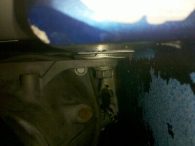

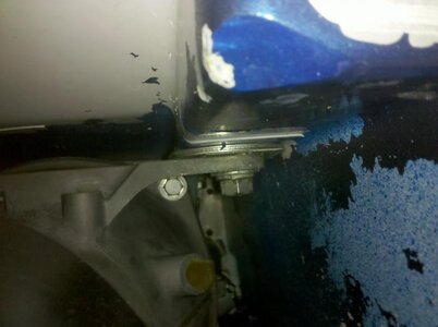

When I pulled this pump out of my 07 hull, I had to use a stack of shim on the rear to get the shaft centered. I'd say close to 4mm on the rear tabs. I put the pump in this hull and it's the same way, about 3.5mm or shimming on the rear. I transferred the reduction nozzle over to the skat mag I just picked up and it's the same way. The mag had a NEW wear ring section too so that eliminates the pump/wear ring IMO. Could the Raider reduction nozzle I'm running just be off that far compared to a stock SJ reduction nozzle? Even if I bolt the pump in tight with just the first 2 mounts, there is still about a 3mm gap between the rear tabs and hull. Pump seal seems square with the pump shoe.
I took a couple picks of the shim stacks I had to use in the 07 SJ hull.
IMG_20111208_182708.jpgIMG_20111208_182715.jpgIMG_20111209_190441.jpgIMG_20111209_190431.jpg
So I guess my main question is getting your opinions on how I should address the squareness issue of the drive shaft to bulk head & midshaft. Side to side is right on the money, top and bottom are off. Can you shim the midshaft? And how about the pump + assload for shims issue? Maybe I should look for another reduction nozzle to try too?
