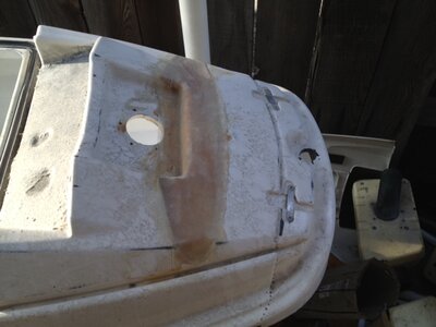

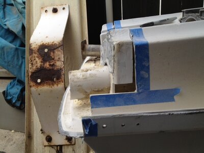

the plan is to cut the rear 3 in.
Rocker the nose
and that's pretty much it, maybe do some glass on the nose to clean her up.
The Kevin's Area 51 build gave me good inspiration to just reshape the existing hull rather than cut a large section out and try (and probably fail) to create a new front end out of foam and glass.
This will also shorten the front end a bit, which may work out perfect in some reshaping of the nose.

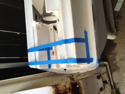

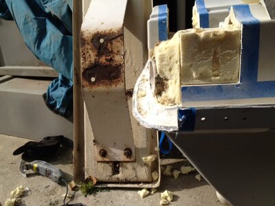

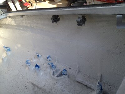

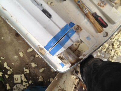

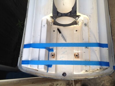

i decided to tape off my cuts. my plan was and is to remove 3 in from the hull and just relocate the rear section forward, less glass work, at least in my opinion.

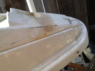

as said before i'm going to mimic kevin's area 51 build in the nose by cutting along the ride on the hull, heating it, and pull the nose up.
i'm a bit lost with the exhaust at the moment, will revisit later.
