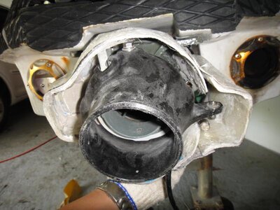

First of all I like all the RRP products, And rick roy is my God so every time when he came out some thing new I always like it a lot, That's way when the flow guard is out I just can't wait to have one, But because the price and the time I decide to build one myself, But building it from what? Is was the main problem until the day I saw my wife's flower port, Yes that's the one so here we go~
Then remove the fiber glass from the port and cut to fit, It start to look like the one I want hehe.. But wait how do I mount this to it?

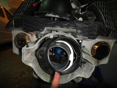

I have the oem trim ring with the rubber blow back and so I extended my ride plate into a flow gaurd to hopefully keep from scooping in water with the turn nozzle and make less drag.

Yeah in theory it should work for less drag and better flow protection. Will it be noticable or not is the question. I don't have rear exhaust or power factor pipe so I don't need it to go all the way around. I used a coffee can. Lol
