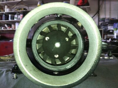

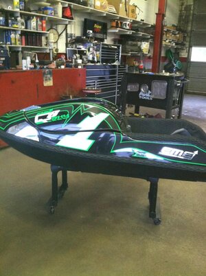

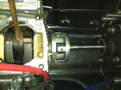

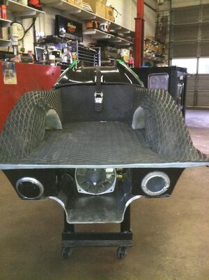

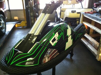

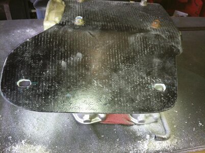

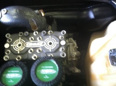

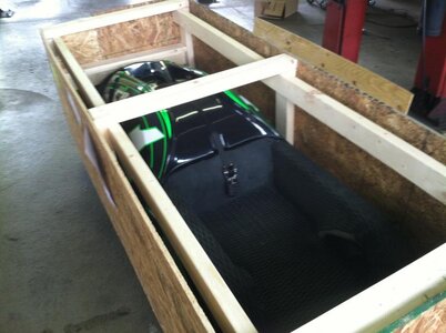

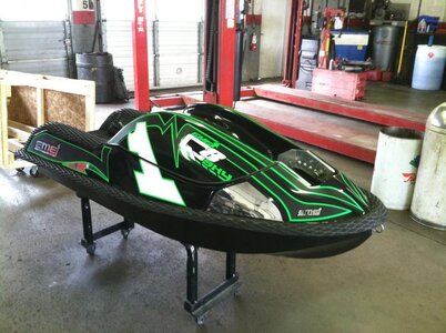

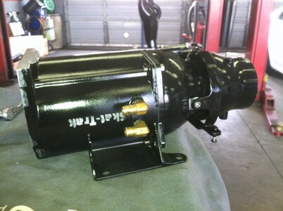

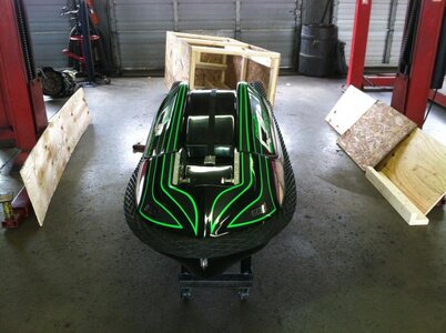

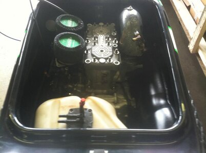

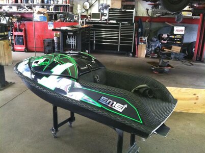

So I picked up a Q8 Sky last week. I am transferring my driveline from my 2005 SXR with a few upgrades. My goal is to get a season out of this engine, and upgrade to a EME 1200, or XS1200 and larger pump for next year! I stripped down my SXR a couple weeks ago, and traded the bare hull for a skat trac 142 magnum pump set back with 13/18 long nose prop with trim. Enclosed is a list, and pics of parts. More pics to come as I progress!

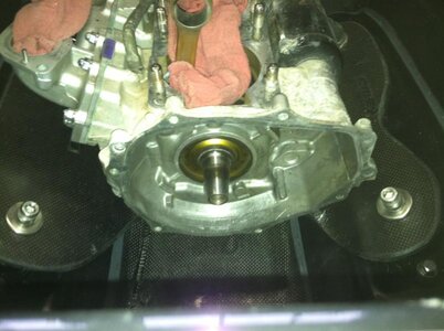

Kawi motor stock stroke 74mmx84.5mm bore= 830cc
Factory wet pipe,exhaust manifold port matched to cylinder
R&D Dominator head (milled beyond Oring, will let you know compreesion in future post),w/girdle kit
Rad lightwieght charging flywheel
cylinder porting
v force reeds
stock carbs re jetted

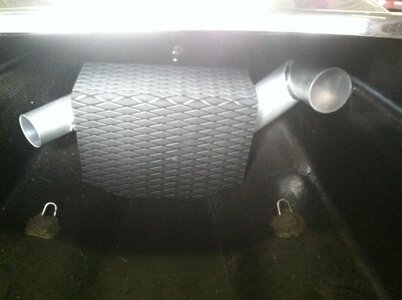

X metal waterbox
have dual exhaust from SXR, have'nt decided if I'm going to use it or not
RRP pole
Skat track 142 magnum pump set back, 13/18 long nose prop with trim
R&D Aquavein intake grate
EME ride plate
EME engine bedplate
