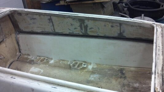

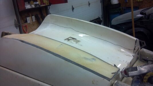

Here is what I did with the back. Cut it 2" and cut bondline for trim. Also defoamed and refoamed. Didnt take any pictures of my hacked refoam job. I use Kawi X2 underhood foam and 2 part foam ontop to shape tray. Nice having friends with x2(atleast kawis are good for something).641.jpg686.jpg647.jpg744.jpg761.jpg685.jpg684.jpg

Reshaped nose(took alot of brainstorming and a couple different ideas thrown around), cut down hood, removed hood liner, and reinforced hood. When I was doing the nose I lowered and moved forward the pole mounting location. This area was heavily reinforced as well.

Reinforced tray walls, nose, engine compartment and a few other areas(used 1708 biax). Ground off ribs and filled bond line before reinforcing engine compatment. Did the driveshaft fill as well.
