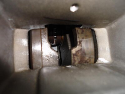

My ski was running great. It GPS'ed at 50mph which is appropriate for the setup I have. It started right up 1st push of the button, idled perfect. It made awesome power and pulled hard from right off idle to 50mph. I had no bogs, hesitations or any indications of problem. No tach so I don't know how much RPM i was turning. I was cavitating some in the corners but overall my ski ran amazing.
Then all of the sudden this happened. It was about the 8th lap around the track hard on the throttle. You can see in the video what happened. It ran great, I rounded the corner, it bogged, made horrible noises, didn't respond to the throttle and died. I had twin 500 gpm pumps running, the hull was dry, and my new hood design takes on very little water in the corners (ran the go pro inside, and the bilges never pump on the track).
I got towed, put it on the trailer and checked the plugs. They were black. Piston tops looked good. I started it and it fired right up, idled and rev'ed properly. I thought it was vibrating a little more than normal, but nothing like omg this thing is F'ed up.
So today I took it apart. Everything looks perfect. I turn it by hand with the head off and it spins super smooth. Before I go any further and make this more compicated than it needs to be, is there anything other than a crank bearing that can cause this? and anyway I can know for sure it's not the crank w/o disassembling the motor.
To me, everything looks perfect, and I don't want to spend extra money on unneeded gaskets and time waiting on them to arrive to reassemble if there's nothing wrong.

There are at least two crank test you can perform with your motor with the head off. First is check for excessive tolerance in rod bearings top n bottom by bringing pistons just past tdc and while holding coupler push piston down with fingers and listen and feel for play. Second is to check for a twisted crank by comparing pistons that they are in sync at tdc and bdc.

you should be relieved you didnt burn a top end or throw a rod. I'd do a complete inspection of the crank and driveline and check for dings in the impellor(fish?) put that ada on and take a nice practice lap and see if there is any noise.

I'm going to split the cases and check the crank bearings on Monday. Everything looks great but I'd hate to have a bad bearing grenade on my minty top end.
