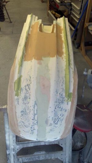

In this pic you can see where I added the built in tubbies and also how I made the strakes nice and deep like an sxr to allow the ski to carve better. The tubbies are 1" wider per side making the width of the ski in the front 3.5" wider than a stock sj bottom when you add in the 1.5" I added to the center of the ski. The strakes were just built up and shaped using a bondo and are about 1/2" taller than the standard sj strakes. The tubbies were make using 2 part foam, then rough sanded to the shape I wanted and then covered with bondo and smoothed
Here's some pics of the finish sanding, I also added a slight concave infront of the pump tunnel like a sxr/sxi pro
