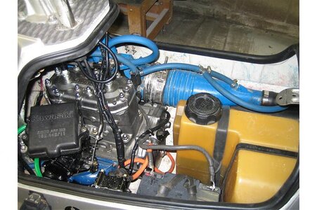

Finally its done....I finished it today and took it for a ride....wow huge difference in power over stock! So much fun to ride! The Air intake worked pretty good, i put it behind the upright seat. Tell me what you think.
Looks great! Just keep an eye out for any water intake on that flame arrestor...if your having issues and its a 44 mik and you still have your stock air box than it can be modified to fit.

lol Thanks guys.....I do have my stock airbox.....But its small....How can i make it fit...I did have a bit of water issues a few times....I could run the hose all the way to the front though and i bet it would solve it

I think that running the air intake to the front would help a lot with water ingestion. . .

Yeah try and run the air intake to the front...as for the airbox, if it is from a 38mm carb you can just mount it on an angle and elongate the mounting holes and it will bolt right up. If its from the smaller carbs than it probably won't fit because the bore would be too small.
heres one mounted on my X2 I just built...
