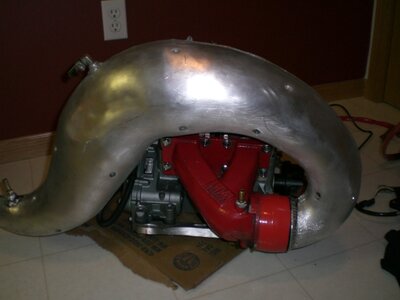

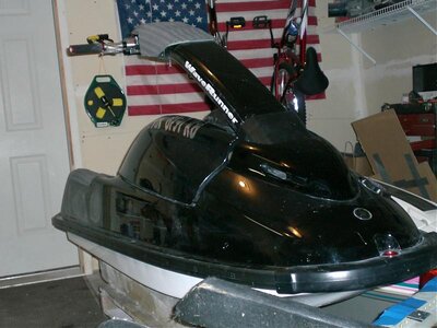

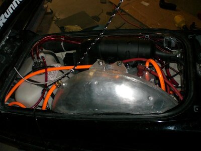

2006 Superjet:
ADA girdled head (37cc)
Factory Type 4 dry pipe
MSD enhancer
Choke delete (stock 38s)
14/18 Solas Concord
WetWolf Cone
Dual Cooling
2" one way valve w/ pump dump
-3" pole
-4.5" steering bracket
blowsion pole spring
Xmetal bars with Xmetal throttle, ODI grips
500 attwood
Waterdawg REV holds
Limiting rope and hood straps
Front air intake blockoff
R&D Aquavein intake grate
ProTec rideplate, cut flush then D cut
-better (more recent) pics to come

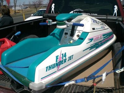

1993 PJS Laserjet F-14:
Everything PJS

I really dont know much about the PJS engine, its a viper 7000. 550 based, the crank is the same as a 550 I believe the cases are a bit different, the electrical box actually mounts to the front of the case, the pistons have 2 boost holes machined into the skirts. Its a pretty fast ski for a 550, the single carb models where something like 55-60hp and the duals where 65-70 IIRC. The hull handles WAY better than a 550 though and they really move on the topend. I think these skis where only made for 2 or 3 years. Ill get some more pics soon.

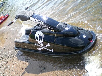

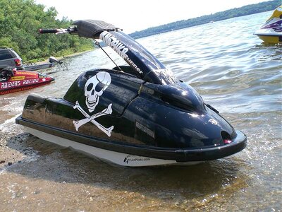

Updated pics of my skis from this weekend...more (clean) pics to come soon.
