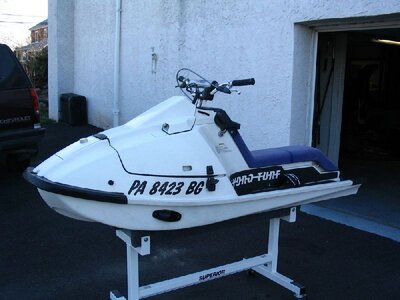

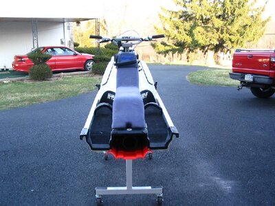

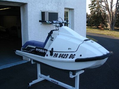

just installed them on my X-2 I used bolts on one side and screws on the inside. It went pretty easy. I will get some better picks this weekend.

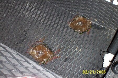

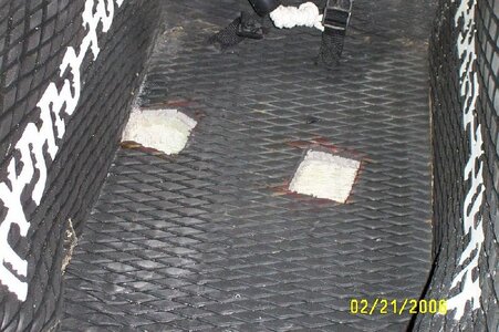

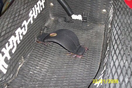

this is the slutty mod I just did a few weeks ago...
i may have overdone the glass a little.....
easy though...
weld an SS acorn nut to a SS washer...ground shwag off bottom so it sits flat..
epoxy, glass..whatever to bottom of hull after a good roughing and acetone cleaning...

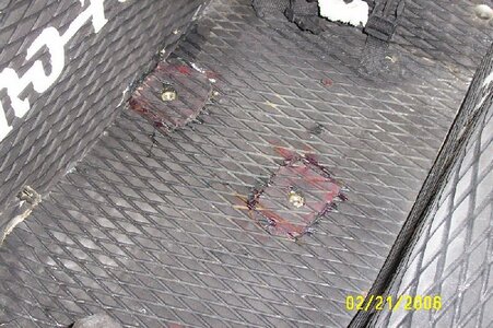

Takeastand SJ said:
I got two 2" X 2" X 1/4" pieces of aluminum, cut holes the same size out of the tray, glassed them in, and tapped the aluminum.
