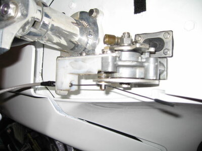

Here is a picture of the trim I use on my X2. I can't do much without it. I made it from a Dirt Harry bike lever, bicycle cable, a hacked stock trim mechanism and a home made bracket to hold the cable housing at the bottem.
When I have the cable adjusted properly I get about 30 degrees of UP nozzle.
I use it for making big setup waves, hood starts, stabs and rolls on flatwater and rolls in surf when I am hitting the wave when it is jst a roller in deeper water if it is small. It is also killer for surf riding/carving faces and re-entering.

So does the nozzle sit at the lower position (all the way down) when the lever is untouched and then tilts all the way up when you pull the lever?
Got more pictures of the cable where it attaches to the stock trim adjuster? How does it hold to it?
Also, what is the best angle to keep the stock trim at for now?(until I get around to do something like you did) Up/Neutral/Down 1 or Down2?

My Nozzle sits at 0 degrees. If you have a full legnth hull and or a 650 motor you might want it to have a 5 degree up when surf riding and 10 or even 20 up for flatwater. I will try to get another picture but I just drilled and tapped the circular thing for a 6mm bolt and use two nuts to pinch the cable. Pretty basic. It allows the bolt to rotate when I pull the trim for less resistance. The stainless think is a pain to tap out but it is fairly thin so if you are careful you won't break the tap.

It is wicked easy to make. The only thing I couldn'd get done in one night is the little 90 bracket. The rest is a $25 trip to the bike shop for a lever and cable then I just cut a bunch of extra off the stock trim thing with the sawzall and lastly drilled a hole in the round stainless thing that actuates the stock cable. It pretty much is the only way to get an X2 airborn in a lake.
I recently discovered that if I spray graphite down the cable housing it makes the lever ten times easier to pull even under power.

If you take apart the trim nozzle and flip it 180 degrees you can then eliminate all the hardware and just use a straight cable and lever. You can either feed teh cable through the (overflow) waterline that sits under the cooling waterline in the pump section or you can go out the stock trim cable line and feed the cable to the other side of the pump.
I did mine this way and it works well. I just need to make a better bracket for my cable to eliminate the slop.

2 more questions: - Is the lever or cable spring loaded so it goes back down when released?
- And what are the parts that need to be cut off.....I heard sawzall at some point.

Take your trim knob thing apart and then look at where mine was. You will see a lot is missing on mine.
I don't use a spring. It returns on its own when you are riding. I tried to keep it simple.

...and cable then I just cut a bunch of extra off the stock trim thing with the sawzall and lastly drilled a hole in the round stainless thing that actuates the stock cable.
I am currently using your pictures as a "diagram", if you will, to customize my trim. I am looking at this thread and I am getting confused at this point^^^. I have the round stainless part drilled and set up, but I am confused as to what you cut off with the sawzall. I noticed that you cut that back of the ski and ride plate off about 2 inches, is this what you are talking about or did you trim something else off in order to get the nossle up to that angle? Also does your nossle go to (-) degrees (point down)? or does it just go to level when you are riding?

The trim unit that is bolted to the top deck that originally had the spring loaded button that yu grabbed to set the trim is what gets sawed. It has some extra junk hanging off it that looks like crap so I hacked it. It might also interfere with the bolt that holds the cable. You need to take the nut withthe cotter pin ot to disassemble it for easy access.

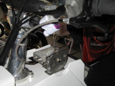

Same idea with mine...I can't seem to get enough pull to give me the tilt I want. I mopved the pull point closer to the center but still not enough and... Since I moved my pump back 2" the steering cable restricts the movement.

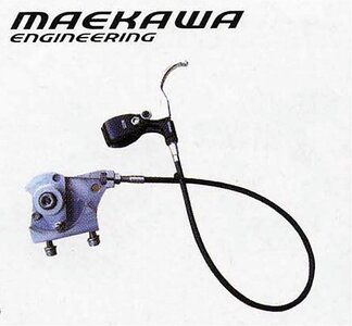

Maekawa Engineering has a nice looking setup for the X-2 trim.
