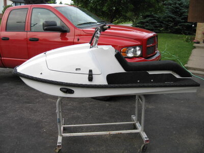

I just figured i would share a bit of what me and my brother have been doing with our x-2's.
First is mine. I WAS running it with the mods in my sig, however I have it in the garage for a RE-Build. The behind the seat intake was dumping tons of water into the engine, i cant count how many times i have been stranded with a flooded engine, and i was going through plugs like crazy.
SO.....I am adding a few things, and i will keep updating this as it gets completed in the next couple of weeks
-I added a 1-1/4 scupper with a homedepot one way valve
-I 5200'd my 1100 Bildge pump down and added a float switch with manual override
-I glassed over the hole i cut behind the seat and modified my hood using 4 tubes under the cowl down to between the gastank/waterbox
-I will be painting the scratches, etc and adding full hydroturf down the rails, footwells and sides....ribbed style.
And last but not least, I am building a small pin 750 for it, Bored to 780 with wiseco pistons, twist head, dual keihn ss/xi carbs, ocean pro F/a's, Jetlyne 650 exaust manifold, westcoast pipe, alum. waterbox. I will be running the 750 electronics box that i will mount where my oil tank was, im toying with using the tach and mounting it somewhere on the dash.
PICS!
My brother's ski is almost done. he is dropping in the 650 with the yellow head, but slowly building the 750 at the end of the bench. he did a nice job on the hood and smooth gascap area, he is deciding if he is going to do a grey stripe up his hood?
