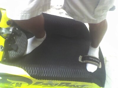

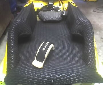

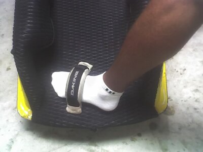

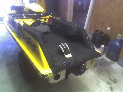

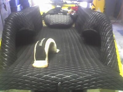

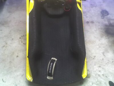

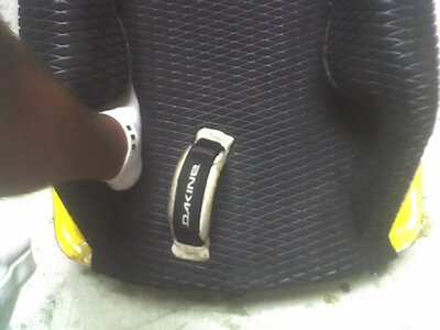

decided to put one on the rear and want it to be removable... bla bla bla..
check it:

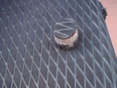

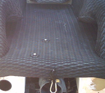

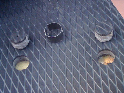

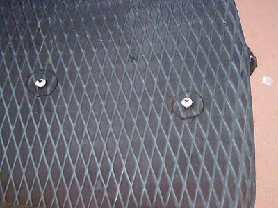

  1. 1.25" hole saw w/o the arbor and bit to cut a pretty hole in the turf
  2. remove any glue
  3. epoxy washer w/ acorn nut to tray
  4. re-insert plug and glue around the sides
  5. align the stap and mount it
now you have a easily removable stap w/ turf remaining in tact...
Hopefully this will help w/ surf stance rolls and other fun stuff..

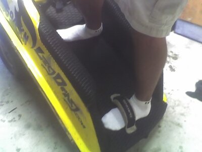

best part is that I still have use of both footholds while it's in due to widening my tray to 16" in the rear... My tray is the same size as a SXR now...

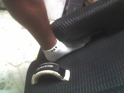

How does that High Roller front foothold compare to your front mounted Dakine footstrap that you use to run?
Me and LBE both have had great success w/ the front foothold... :cheer:

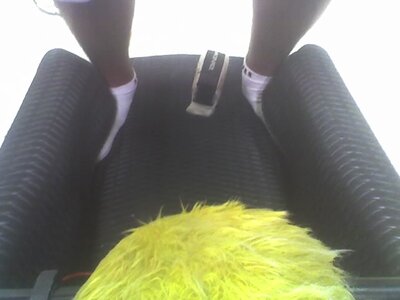

I like it for the manuverability... I can put my front foot where I want to (from side to side) and still be locked it very tight, if I want to. A strap will require you to adjust and fine tune the position... The front hold is a mount and ride mod that requires no adjusting....
The reason behind the rear strap is that I think it's good to have the rear foot centered in the back of the ski for balance... I noticed that it would throw me off sometimes, if I would have the rear foot in the left hold... it kinda puts you in a offset position... (I don't know, just feels strange)...
