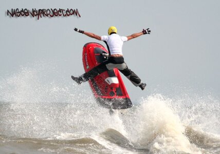

Of course I got no good pics of them fully extended...

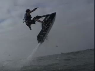

there is a good pic of slutty doing a nothing from the dallas ride on a blaster...
yeah... this is the standup version though... I guess most things still apply... I think they are a lot easier w/ fixed steering though

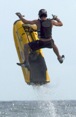

nice... this is one I did on a B1 that came out really nice..
