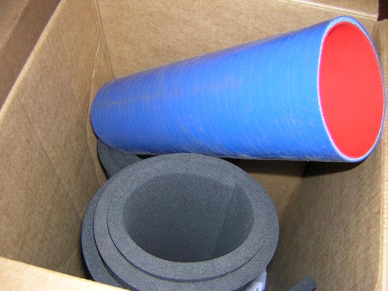

High Temp Silicone Hose, 3.5" ID, per foot (for Riva type 9): 5296K84
High Temp Silicone Hose, 4" ID, per foot (for B-pipe): 5296K631

Turf Underpadding, Neoprene/Vinyl/Buna-N, 1/2" thick, 57" wide, per foot: 85175k291

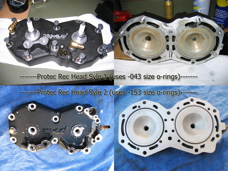

Protec Cast Rec Head O-rings:
-Style 1*, viton, -043, pack of 10, viton: 5267T57
-Style 2*, viton, -153, pack of 2, viton: 9464K114

*Protec o-ring note: See pic #4 at bottom of post for visual differences between the two styles of this head.

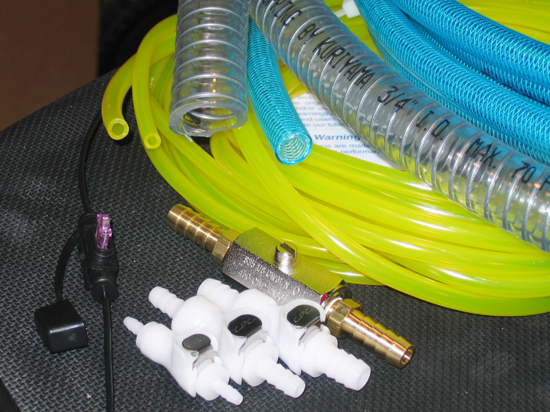

#1: Shows the screw porp valve w/ 3/8" ends on it, the fuse and fuse holder, the three different size quick disconnects (1/8", 1/4", and 3/8"), the tygon fuel line (3/16" and 1/8"), the braid reinforced clear blue cooling line, and the clear wire reinforced bilge line.

#3: Shows the B-pipe coupler stock (now a diff pn) and the 1/2" turf underpadding.
#4: Shows the differences between the two styles of the protec rec heads.
