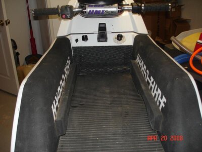

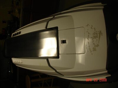

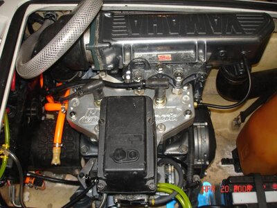

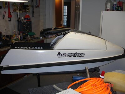

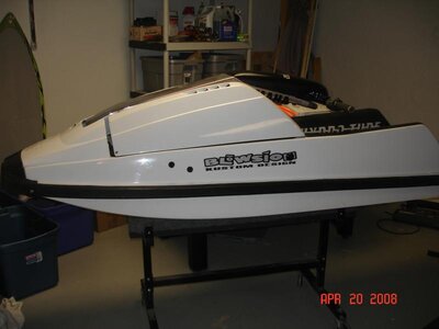

Here it is. I built it for my wife so she could ride with me.
1990 Hull
Now with a LPW freestyle ported 62T
Factory B PIpe limited
ADA Girdled head
Lightweight flywheel
AC aluminum pole
Quick steer Blowsion bracket
UMI 0 degree bars
ODI grips
worx 201 intake grate
Skat swirl 13/17 prop
wet wolf freestyle cone
R&D proseries ride plate
Tom 21's footholds
Rule 360 bilge and stock siphon
I also cleaned up the bottom of the hull with a coat of gelcoat.

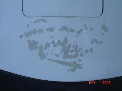

I de-stickered the hull with a 3M pinstripe remover. It worked great everywhere but the nosepiece where it took the paint off. I need to find a sticker to cover it up and finish up the ski.

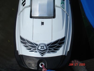

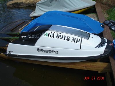

Dubs chops is gonna design a graphic of some cool wings for the front. I'm gonna get some black x-h2o stickers for the gunwhales too. I'll post pics when I can.
McDog
Other Administrator
South Florida
Mad props to dubs chops
Finally posting a pic.

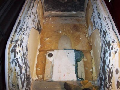

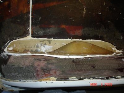

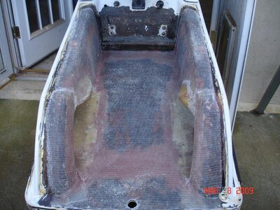

jfw432 is defoaming for me while I turf his ski. This thing was completely soaked. I'm guessing it will be 10-15 pounds lighter when I'm finished.. I'm planning on installing tom21's footholds. One way valve, polytyrene, and drain plugs are going in too. I'm putting TL on her ski if I can ever find a TL flywheel at a reasonable price, I have everything else.

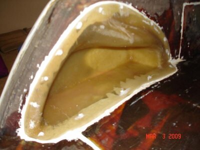

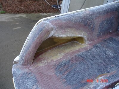

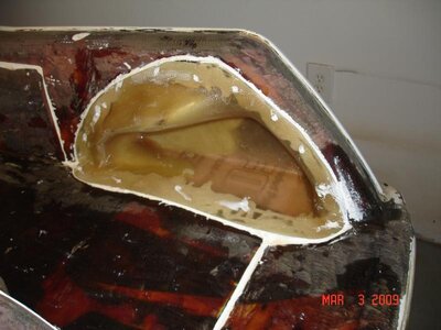

Tom21's footholds are in. These were so much easier to install than my REV's were in my rn. I put some drains in and refoamed with polystyrene. A little bit of 2 pound foam was used in the gunwhales and to lock in the polystyrene and tray. Pad and turf is next. MSD TL is going in too. No B pipe yet, but I'm on the lookout.

Looking good, wish I could get my wife to ride! Get that ski back together for the secret spot ride in April! Weather's warming right up.
tom21
havin fun
clearwater FL
looks great! I think they fit a square even better than a round. you may want to install a thin piece of pad on the ankle area down and probably a minimum of 1/2pad on the top of the hold. mine is still a tad sloppy. I think I definitely made them big enough!:beerchug:

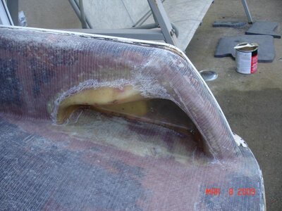

Fiberglassing the tray and tom21's footholds with 12 biax.
