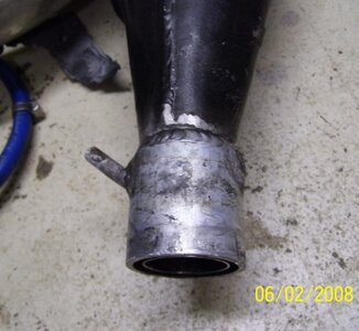

also, here is a pic of what appears to be a modification on the end of the chamber, the ID has been reduced.

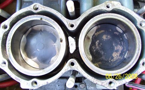

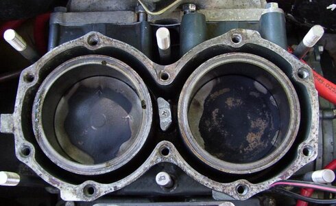

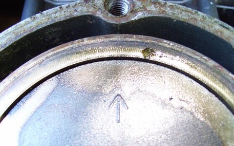

here are some pics of the piston wash.
pto looks good to me.
mag cylinder looks odd.
BUT, my start/stop died on me and I swam it in, and then upon trying to recrank the old relay stuck and the starter was spinning for 10-12 minutes until I got it on bank and removed the battery cable.
anyway... any thoughts on this pattern?
