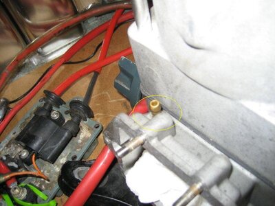

I bought this motor as is from a fellow board member here. There is only the original stock pulse line fitting. I believe he was using dual carbs with an external fuel pump, hense the need for only one.
I do not have an external pump. I was debating just using the one fitting with a tee to both carbs, but given the amount of money I just dropped, I rather not starve the motor or some sort and not have adequete (sp?) flow through the line.

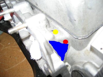

Picture two shows my idea for two possible locations. The yellow dot represents a mirror of the other (stock) side. This can only really be done properly if the cylinder is pulled which I really rather not do as the motor came running to me and do not want to crack it open if at all possible.
The second option represented by the red dot which seems like it would work and would take only moments to do. Basically just drill and tap the side. The blue represents the profile of the reed cages which does not look like it would block the hole.

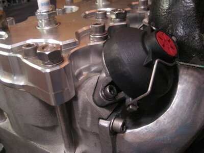

Just wondering what everyones advice is on this. Picture three is for fun and a teaser :Banane09:
