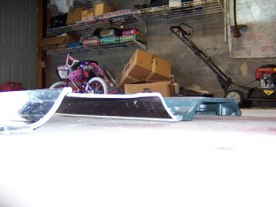

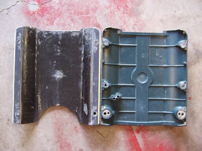

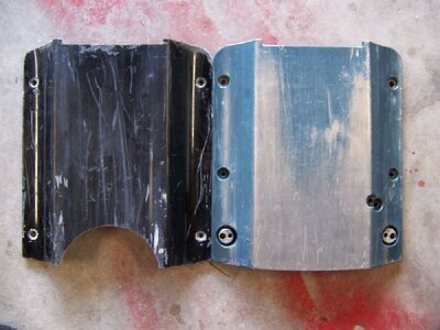

I'm a bit late, but just did mine today. I haven't ridden it yet though.

Nice job Darin. Your wammer plate is allot nicer than that POS wammer sent me a couple years ago. You will love how crappy it makes the boat handle :biggthumpup: I mean that is a good way

I've ridden several skis with them, just never took the time to do mine and swap it out until today.
My ski is so hard to ride fast anyway, doing this can't hurt that much more.

how did you get suck a clean cut, looks like to took a big hole saw to it.
SuperJETT
none
Many many years of Dremel'ing young grasshopper. I can make Mt. Rushmore out of a single cube of ice in 3 minutes flat in direct sunlight with it. bwahaha
