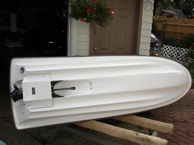

Yea I would say the hull has amazing fit and finish and I am very happy so far.
Of course I need to go beat the hell out of it for a while to really know for sure but it feels very solid and a little lighter than my refoamed (but wet) and reinforced 96.
I should be losing nearly 20lbs when it is all said and done but I am taking accurate weights of everything just because I wanna know.
Even if was 10 lbs I will be happy but I have already ditched 19 that I am seeing:
hull -vs- hull with same stuff on.....-15.5lbs

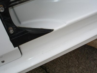

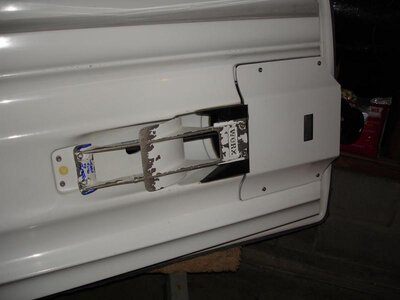

Also cleaned up the pump shoe a little as I would prefer not to lose another one of those ever again. Just filed it in to a the lines of the hull so it won't grab.
Thanks to the Smurf for taking the intake grate off my shoulders.:notworthy:
Pump fits perfectly!!!!!!! Balls on!!!
I am getting more and more stoked daily!!!!

Its a OEM Yami pump shoe so I think it has to be custom.
it looks like a Kawi pump shoe is suppose to go in there. you can see the ridge where it would mate up to the hull. Gonna have some interesting waterflow characteristics.
crammit442
makin' legs
here
I think he's right. I believe I'd fair that Kawi shoe area in so you have smooth flow into the Yami shoe. I'd personally ditch that OE plastic shoe and replace with an aluminum shoe also. It's much easier to do now instead of in the middle of the summer with the motor and everything installed.

Did some preliminary fitting today. Intake is being done as we speak. Thanks again Brian!

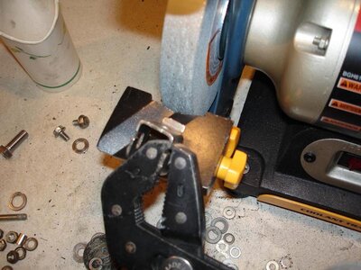

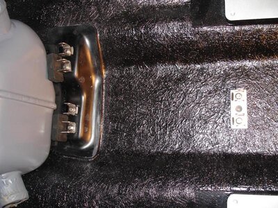

Ground the mid housing. Ground the tangs off the OEM strap mounts.
