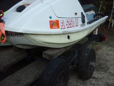

At first imperssion they are well built and i can't even begin to compliment
the fit. they go on like they should have been there all along. the only draw back was the fact iI had to do the exhaust outlet myself( no biggie ). placed them to the hull, drilled for the pop rivets ( 1/8" x 1" ) roughed up the hull, then installed the sponsons w/ the rivets, followed that w/ 1 layer of 6oz cloth w/ a mixture of epoxy and cabosil. have not faired them in yet since i will be doing a bottom mod before the new paint ( entire ski ). :smoker:

they rock in the surf and can only be the same on the flat water. the extra lift from the outer chine running almoast to the front of the ski is sick and allowed for a much more stabil ride in the no wake zone
TOM YOU ROCK AND IF YOU OWN A x2 I WILL RECOMEND THESE W/ MY HIGHEST REGARDS TO THE PERFORMANCE GAIN AND THE FABRICATOR !!!!!!!!!!!!!!!!!!!!!!

at that height they follow the line of the bottom of the hull quite well and the curve of the bond line they will get faired in w/ filler before paint that has to be cosidered as well.

i've been running the same tubies as crab since jan. and they were great, these trump all the others forthe x2. the extra 3" of lifting surface makes all the difference in the world on this ski.
i believe they are 175.00 from tom
PM tom 21 and he will get you set up right. let him know that you saw them here for the right price

I've got a set of sj tubbies that don't quite fit right (you have to bend them to sit flush with my x2 hull)........ so I might hit tom up for a set of x2 tubbies.
I'll prob sell the sj tubbies to offset cost.
They are the blowsion sj tubbies.
Good to hear they make a difference.
I've been hesitant to drill holes in my hull until I knew these actually made an improved difference...... sounds like they do.
How are they on a buoy course?
