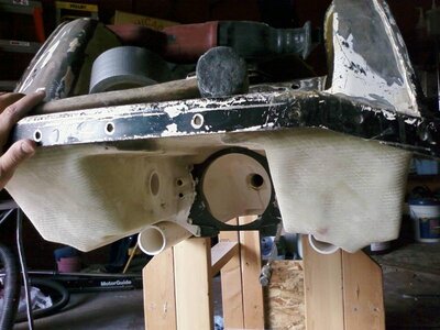

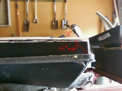

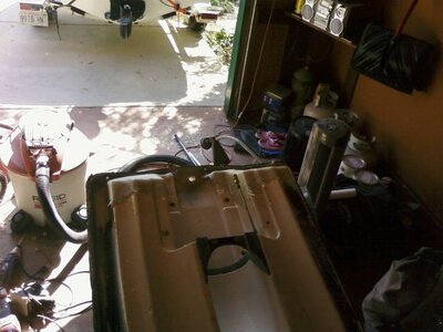

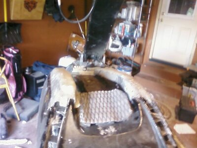

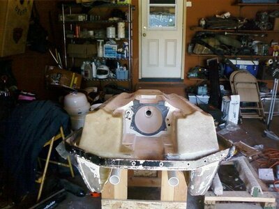

1. shortening my sn hull 3 inches. (the 45* angel one)
2. im also cutting my side rails for looks
3. adding a second cooling line, and a trim like .
4. adding a one way (nemo's build)
pics will be uploaded as i go.

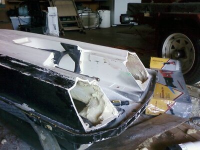

here is what i got done today

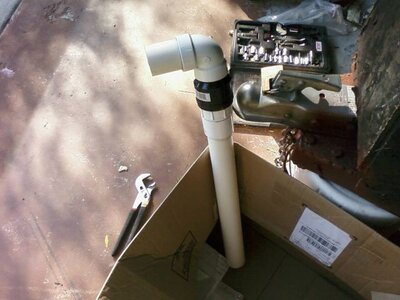

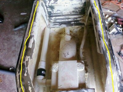

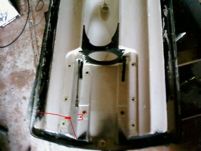

here is what i want to do with my siderails
i really just like the look (i know it looks liek an SXR ewwwwww) he he
but i cant start now cuz i gotta wait for my epoxy to come in so i can glass my tray and other stuff back in.

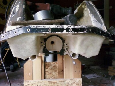

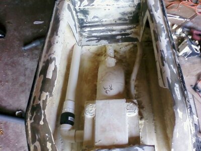

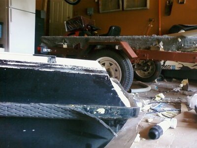

ok guess well heres my wet glass on the shortening
after i gett home from work if its dry i might start sanding ... otherwide its tomm morning !!!
and i dont think i can widen my tray, my rev's fit in perfect so i think im just gonna leave it how it is .
Hey slacker, whos boat is in the background? Did you put the back piece back on and glass them in or just make a new piece (where you cut the 45* angles at) the ghetto wagon may never live again:spank: or maybe it will and jsut won't float as trying to go :barrel::Banane37: get back to work slacker:1zhelp:

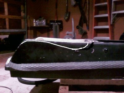

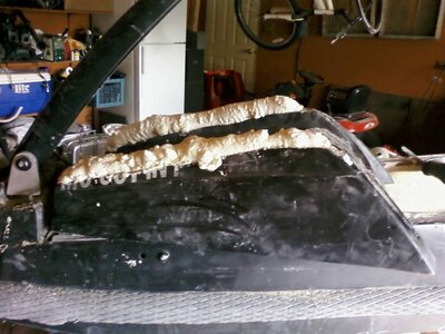

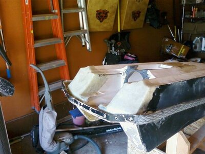

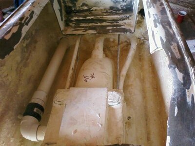

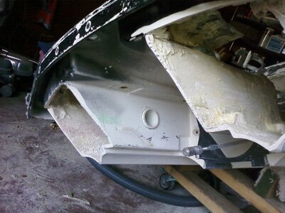

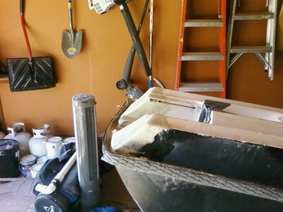

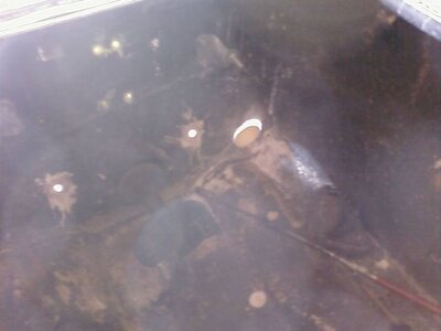

ok well i sanded some of my glass so the edges were smooth, gonna put on maby 2 more layers and then waiting for my tube of 5200 to come in so i can seal everything nice and good.

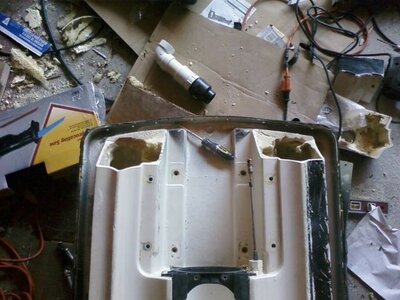

i had 2 hoods and i seen someone that is in the process of lowering their hood, so i said why not and im gonna try it too. so i cut it and i put foam in it and waiting for that bad boy to dry and just gonna glass over it
and theres a pic of my trim housing too

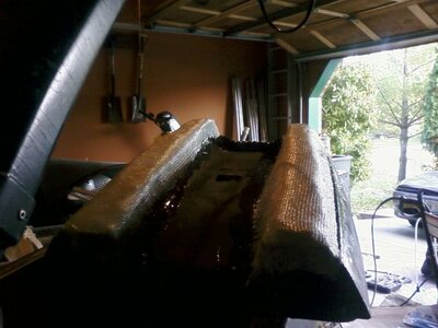

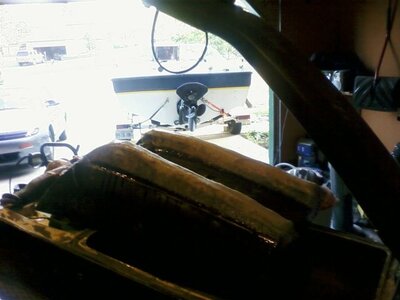

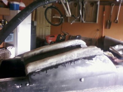

ok well i shaped the foam and put just one layer of glass on for now . gonna do one or two more when its dry

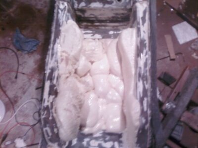

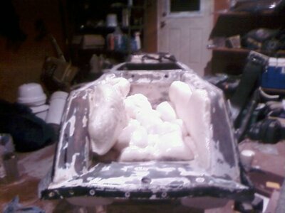

well i added another 2 layers of glass on my shortening, and heres some raw foam pic still gotta cut it down, i also decided im gonna widen my tray too.
think im gonna be cutting my gunwhales tomm !!!
