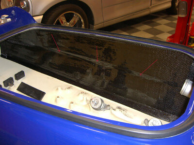

Check out flashsj's 08 SJ in the build section...his boat is looking sweet (all new stuff). Picture below of his boat,with the bond line pointed out in red.
He also dressed it up with a little CF tape on the edges around the perimeter=strong.
