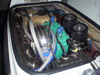

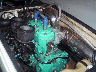

i got a factory b limited pipe + dual water lines.
the chamber + head pipe are out, but i still got the ex manifold on the motor.
that stock waterbox will not come out.
help !!!

i had to remove the engine on my 750sx to get it out. dont think u can get it out without at least sliding the engine forward in the in the compartment

pretty sure the engine has to be out. its only 4 bolts, a throttle cable, stator plugs and the hot wire to the starter to yank it... 8 minutes tops.

dam it, i only need about 1 more inch to get it out.
thanks for the wisdom.
get wet
gorilla
gorilla
There's Always A Light At The End Of The Tunnel !!
Lost Wages NV

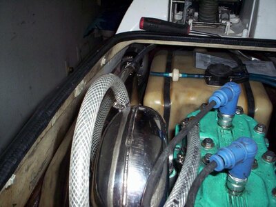

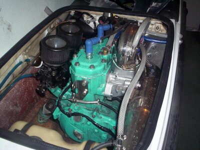

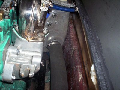

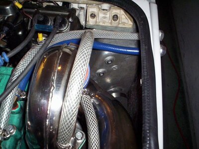

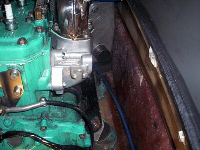

got it out with out removing the motor.
i had to take the factory pipe ex manifold out.
i left the starter in.
it was tight but now it's clean up time.

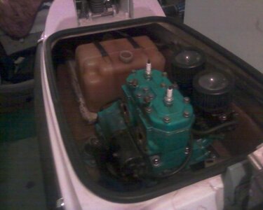

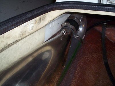

i sold the factory b limited pipe, the sxr800 wet pipe would not fit, but a old school jetpro 650 x2 pipe will fit.

hawk, it's about the same top-end.
the jetpro pipe made it more rideable for me and my fat a$$.
i still am testing the idea about the waterbox going around the front of the gas tank.
i have a complete 550 gas tank and that should give me the room i need for a waterbox.

yes, but 750 pipes are made fatter and larger to offer a broader range of rpms control. putting too small of a pipe on a big engine will result in too much back pressure and too high of rpms. you won't get as good of low end response out of a 650 pipe because with that engine setup most of it's hit is upper midrange to top.

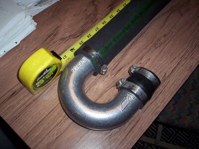

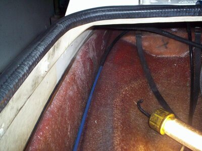

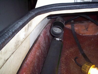

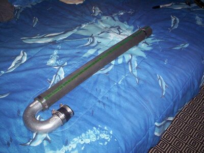

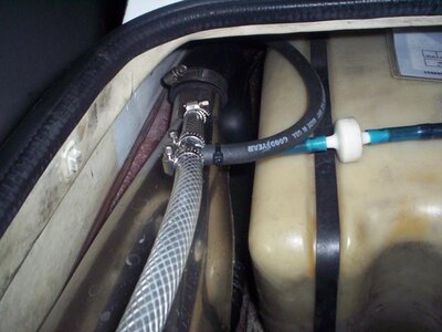

ok, here's the cheap way out to putting another exhaust on a 750 sx-sxi-sxipro.
the hose was about $55 and the u-tube was $33 and came from gordy30 on fleabay.

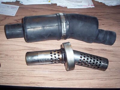

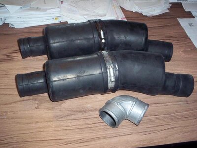

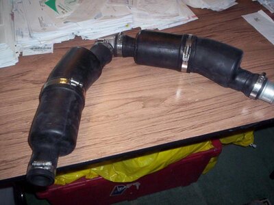

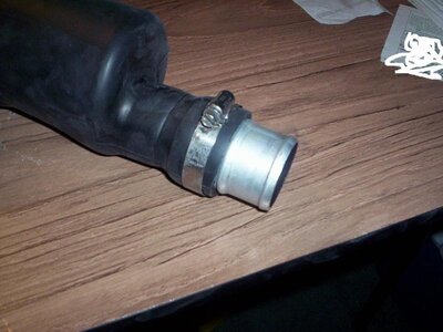

here's another waterbox setup i'm going to try and get up in front of my gas tank.
1 kawasaki 650sx-x2 stock oem waterbox adaptor
2 kawaski 300-440 oem rubber muffler's.
i used this setup in my vintage 440s/s and the 550mod's i raced in the stanup classes back in the day's, and they worked killer.
it was the cheap way out instead of paying big banana's for the pjs rear exhaust mod.

ok, everybody had there own story to tell.
yes, those might blow up too, but it's got to work better than that chit behind the ebox ???
