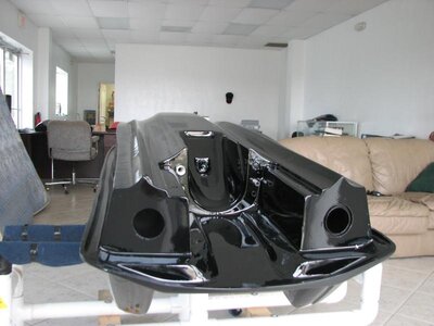

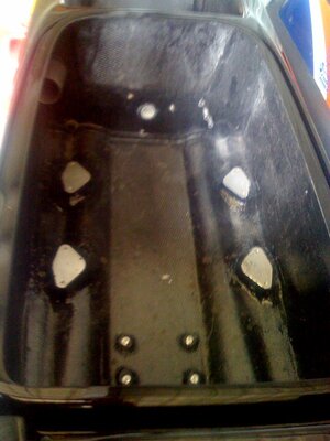

I started building a flat water SJ. Picked up a Carbon SJ "BF Hull" from Tim. Nice & light, Hull is 55.5 lbs foamed, footholds, tubes, 1 scupper, painted!
Bottom is wider than 07, but not as wide as the 08. BF Hull 2 in shorter.

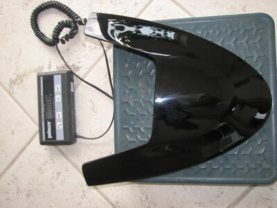

Carbon Hood, Low profile 7lbs painted inside & out.
Paint: All Black top & bottom. Going with White Turf & White Rails
Build details,
Motor: Xscream 860 6mil/ADA 5 Port cylinder (Pulling this motor out of my surf ski). B pipe, Dual 46's, MSD Digital TL.
Xmetal Waterbox ("Rear exit only")
Jazz 3 gal tank from Virgin
Stock 144 Pump with Skat 14/18 . Going to add a TBM pump cone.
Carbon ride plate by Toby
Thrust Trim system
Xmetal pole (Adjustable) going to use my -4 until Xmetal gets these in stock. WDK turn plate.
Xmetal Hood hooks, Xmetal Scupper.
Blowsion Brap strap
Pancake Pete FFH (#3) Can't ride with out it!
Robbie at CP hooked me up with some oem parts, mounts, hood seal, pump shoe, etc.
Chris "Jetmaniac" hooked me up with all the small parts, battery box, tie downs, hardware, etc.
More PICS to come, Should have it on the water next week.

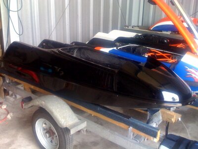

mcdog; What are you gonna do with the LPW hull?[/quote said:
Not 100% sure yet. Either going to build a Xscream 827cc "Stock Ebox" for it & keep it or build a 701/760 & sell it.
Got any more pics of that hull; the thing looks sweet. :bling:
Will take some pictures tomorrow with the hood. Painter still had to buff the hood.
I can't wait, this ski will be at least 70lbs lighter than my Orange ski!

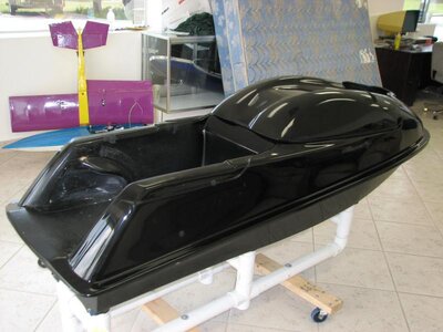

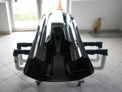

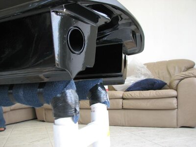

Here's some more PICS.
If you look at the bottom you can see how the hull is wider in the front. Also checkout how the nozzle/pump section is trimmed for full turn w/trim.

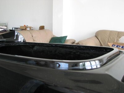

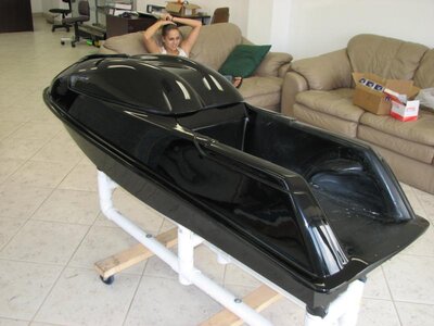

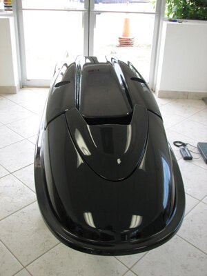

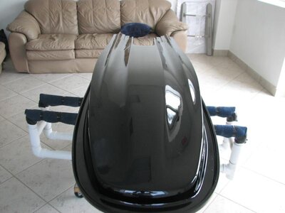

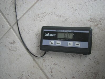

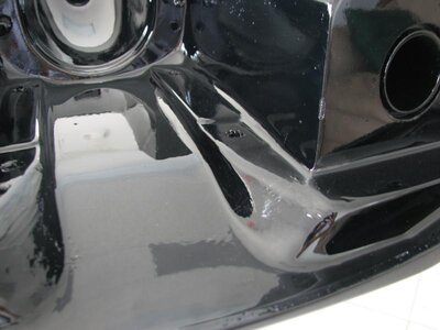

Upper Hull PICS.
Hood weights 6 lbs, painted inside & out.
Nose cover weights 1 lb.
Also note the raised hood seal to keep the hood from blowing off on failed rolls!!!

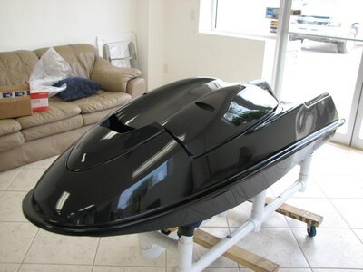

So more Hull PICS. Going to assembly it Monday!

i love how that hood doesn't protrude into the tray area. I hate my WDK for that reason.
I like how short this hood is, I also have a WDK & 24-7 hood .
If you run a Pancake Pete FFH the long hoods not a problem, other wise it could get ungly!
Also great clearance for a trim setup; Is the pump setback any further?
Stock pump location 96-07.
I can't wait to ride it, its so light!
