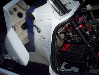

I uploaded some pics of the mods I made to my x2 hood to help keep water out.
Removed the top hood scoop and covered it, Removed the styrofoam and hogged a hole through it and the rear of the hood for a breather tube. breather tube runs up and on top of the gas tank. So far it has worked great for keeping it dry. relocated the hood latches to pull the hood down tighter and added some hood straps also.

I will warn you, mine was upside down running for like 30 seconds and really filled with water.

I tried to make the hose long enough to run up into the nose, but it could stand to be a little longer. Ideally, the breather hose in the hull should be up above the waterline when flipped over.
mine hardly stayed up when I sunk it once with the hood foam in, I bet it really went under fast w/o any foam. :bigeyes:

That's why you run the tubes to the stock water traps, and refoam the hood afterwards....

That looks nice Fletch!
I pulled the stock styrofoam out and hogged a hole through it and shoved the breather hose through. Also blocked off the inside hood air hole on the pipe side and put some turf on the carb side to deflect water away from the carb.
