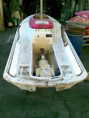

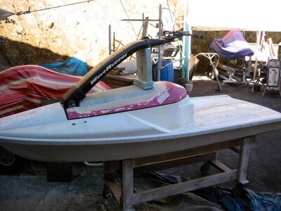

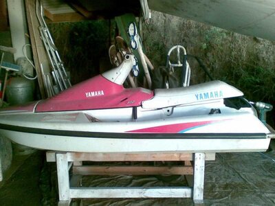

hello, I try to explain and post some pics of my new project , so be cool with my bad language ....

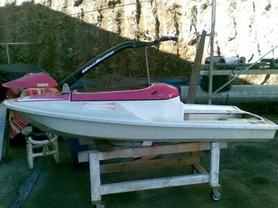

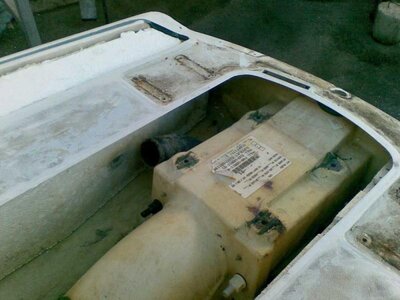

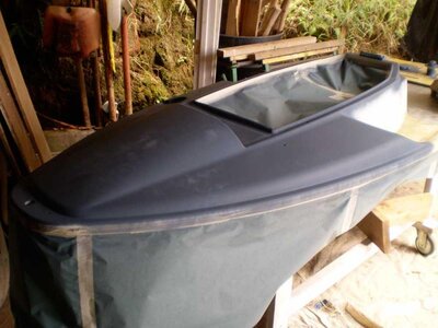

in first I take old WXR run , if you remember this model, he was not very funny , and he has a bad balance with 2 person on board, cool , I'm looking for a small hull ....

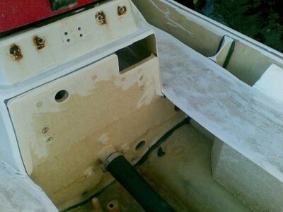

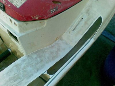

I found a hull and start to cut ......to cut everything :smile:

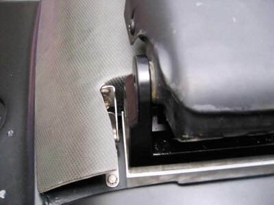

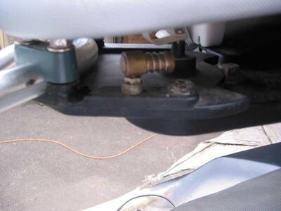

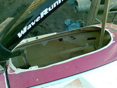

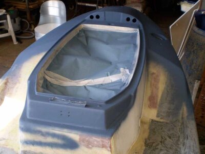

loictahiti

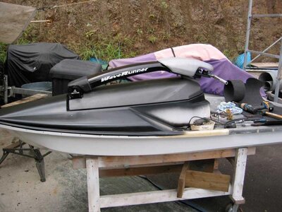

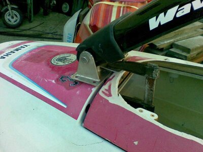

after that I cut the hood, and try to find the best place for the new steering system.....

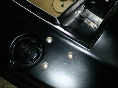

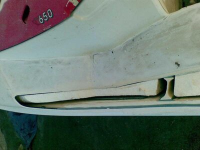

loictahiti

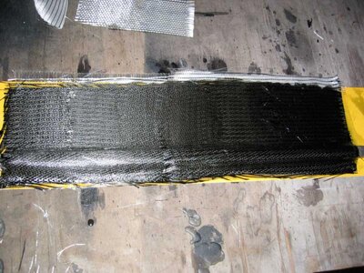

after some test , the handepole is too on the front, I've to make a new space . I 've made a plate in Carbon , and use a aluminium plate inside , to do something strong

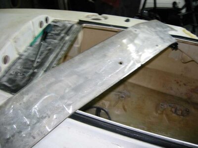

loictahiti
all the hole are epoxied + rowing , the new handepole place, is very good, and it seems to be enough strong for futur hard ridind ahahaha

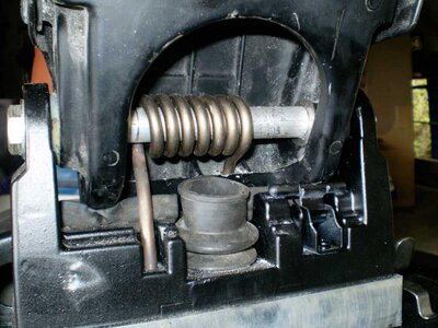

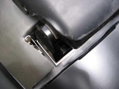

loictahiti

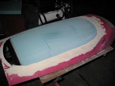

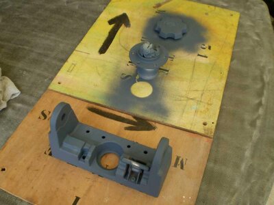

I use 2 kind of foam, in block ,I found it on road side hihihi , I don't know the name, but it's POLYURETHAN and 2 parts liquid foam .

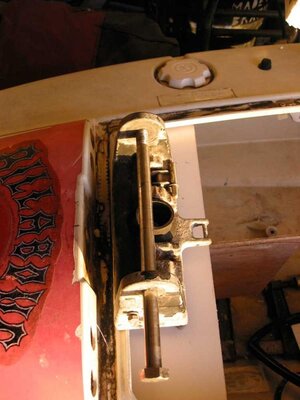

I use the SJ SN hood hook , hard to fit in, but it's works fine and need to change the steering cable (too short) and use a WR 3 cable , a little bit long, but I need to move the end of cable on steering plate
I made a big spacer between hull and handepole bracket, and modify the stock spring and put aluminium pipe

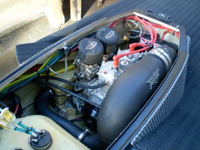

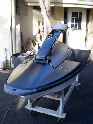

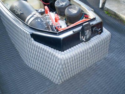

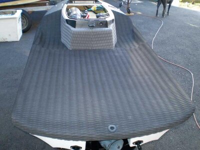

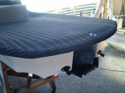

loictahiti

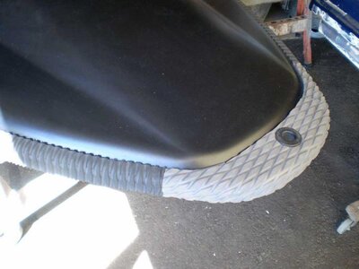

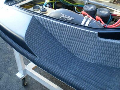

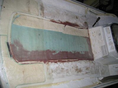

it's time to glued and see inside .....the 17 years old engine :Banane09:
