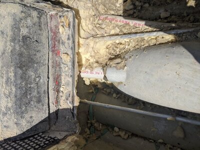

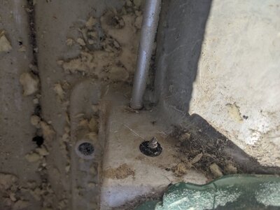

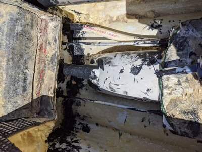

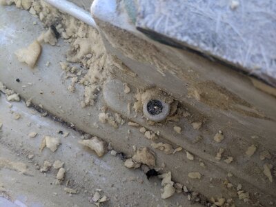

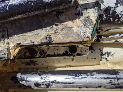

Yes it sucks. You can try a wire wheel on a drill or a pressure washer etc. Add real drain plugs to the rear and use solid foam like the sheets of the "pink stuff" at home depot. Do not use pool noodles as they absorb water eventually.

Im on the nampa valley which is apart of BoiseYes, pool noodles are made of ethafoam which is what we used to carve bulkheads out of for our fiberglass white water kayaks. And it does absorb water. Styrofoam does not.
