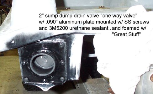

I started stripping her down, grinding the ribs on the inside of the engine compartment and prepping it for paint and re-inforcement. This usually the worst part of the process IMO... Very dirty and itchy not to mention the fumes... Once I got all that fun done, the pumps out, all the trim is removed, she is sanded down and bare... I cut holes for my footholds, Lowes one-way (check valve) It's actually a "sump dump drain valve".
See attached photos below, also check out my online pictorial of the build for more detailed information: http://www.jetskier79.com/gallery/yamaslut
