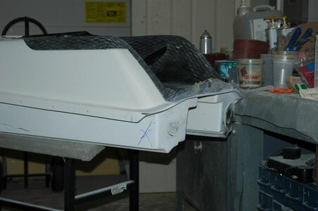

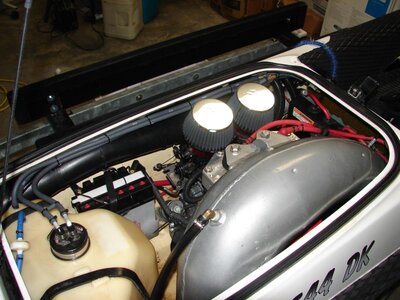

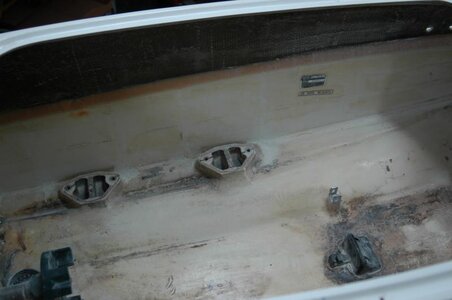

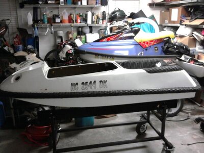

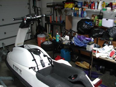

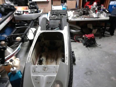

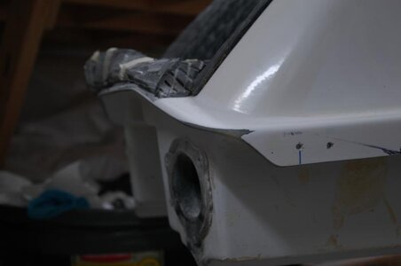

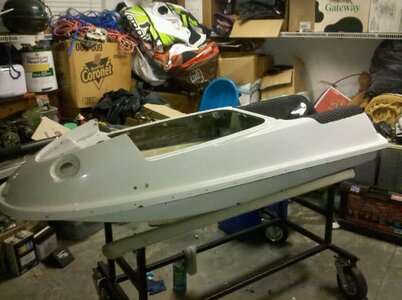

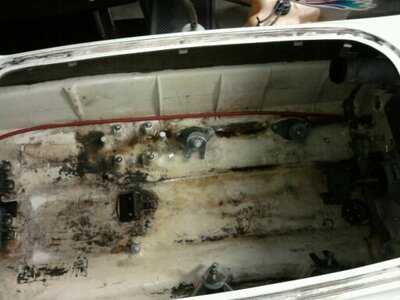

Well got some deturfing done and got the ribs grinded down. Also sanded down the bond rail where the two halfs meet up.

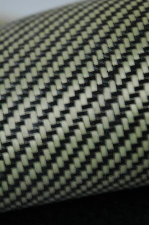

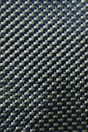

Got some carbon and some hybrid for the reinforcing more pics soon.

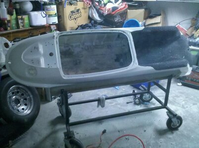

OK heres and update, I have all my needed parts now so this thing should be comming along real soon.
Here are some pics

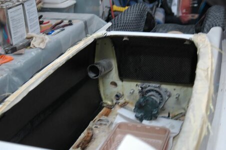

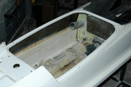

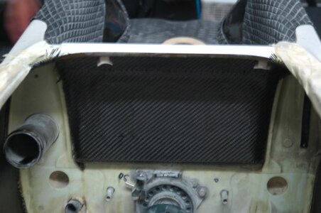

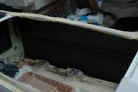

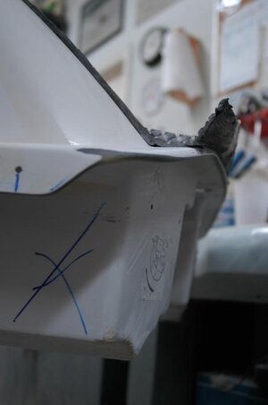

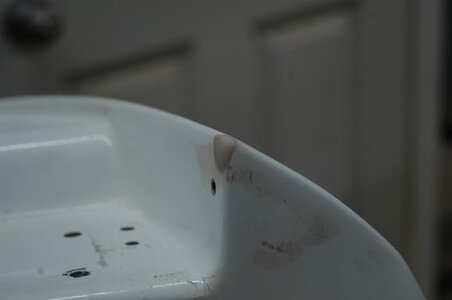

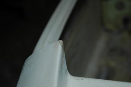

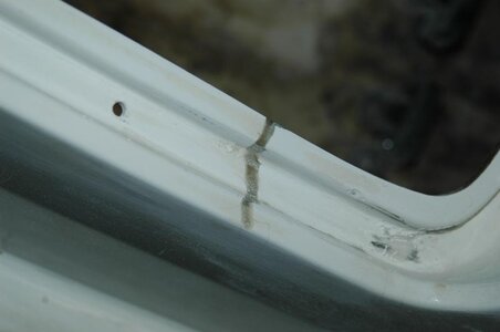

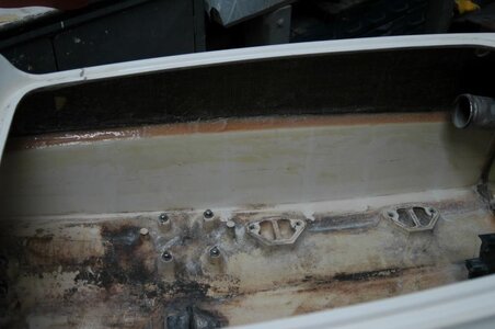

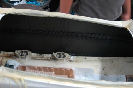

I have cut the rear bondline. Fillied the bondline on the inside ready for some carbon and hybrid. also I had to fix a crack in the hood lip and also fill and reshape the corner where the nose piece mounts.

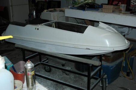

So I am to get all the hull work done this week and into paint this weekend or next week. Motor should be done by the end of the week aswell.

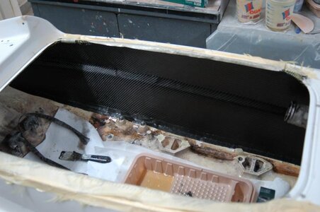

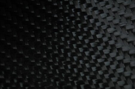

Well I got the sides and back done. I ended up going with two layers one hybrid 6 oz and one carbon 10 oz. Gonna get the nose and bracket area done tomorrow.
