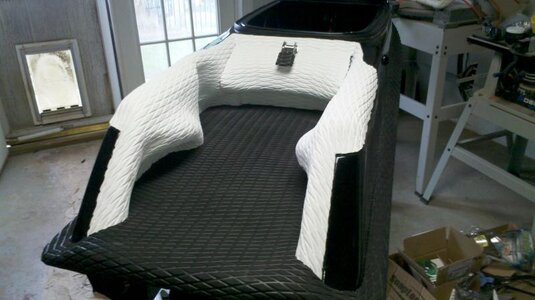

I bolted and epoxied the ffh on yesterday and had enough time to snap this pic tonight. My wife, myself, and my two kids have been living at my inlaws since last wednesday while our hardwood floors get redone after a water leak. This sucks. I want to sleep in my own bed and I need to work on the skis but life keeps getting in the way. I hope to move back in tomorrow and get this ski done this weekend so I can start on the wdk ski.
