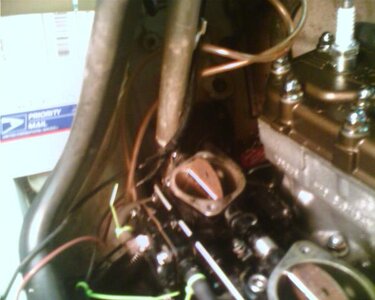

Ok so how do you do it? The rear carb hits the support. Does anyone have any picks of the bracket they mad to fit it?

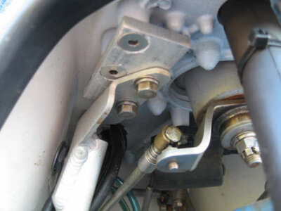

I found a pick of a bracket that westcoast used to make over on that other site. Looks pretty simple to make or has anyone done anthing else?

Get another left side hull support (I have some) and with a little tweaking it will fit there. The left side has a way better sweep to make it clear stuff. I have this on mine to clear my super long quicksteer extension. You can see there is quite a lot of room after it is changed.

Pete, I was going to ask if i could use two left but wasnt sure about the structural part of it. The stock one looks like it double as a support rod.

D_Slicker,
I remember reading up on West Coast's old site about the relocation bracket. You might want ot get ahold of them, they may still have some. I got a grate from them for like 10 bucks once!

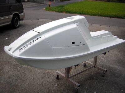

Yeah those braces are sweet!
I want that whole hull they sell.
You get the hull, hood, brace like Fletch's, steering system, and the steering cover for 7k. But then you have to have it shipped over here and then the customs fees.
So really isn't worth it!
