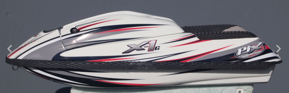

So awhile back (September) I purchased a PJX hull (off Craigslist). They had 2 up there. A glass version:
And a carbon version:
The glass version was a lot further along in the build. It was turfed, it had graphics, engine mounts, etc. The day I withdrew money from my account to purchase the glass hull, the hull was sold off to another member here on the forums. :-/

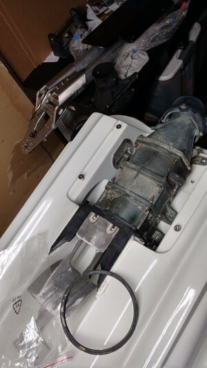

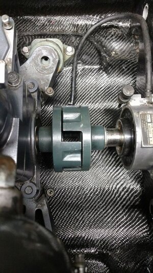

When I started doing the dry fittings (using extra accumulated parts of of the years) it was becoming more apparent at how much more work I was going to have to do to get this thing built. I had casually read about turning down the midshaft to press it into the housing further to work with the stock SJ driveshaft, and I read about how adding an extra wear ring section to the pump allows your to use the stock driveshaft in a “setback” style pump.
A few things I didn’t realize until purchase was the wear ring needed to machined about ¼ inch to have the bolt holes line up. When I realized that, I’m thinking, no problem. I’ll just get it machined… But finding a shop locally to machine it has been a lot more trouble than I thought.

I’ve ordered (what I hope) is the last few things I need to build this. Waiting on a custom drive shaft to come in so the fun can begin! I didn’t like the idea of machining a stock midshaft to press further into the hull, so I’m using a GP800 midshaft with a custom driveshaft. (Also thanks to JM)
