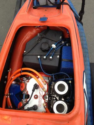

I got to look at the parts again at the clinic. Derrick Sr thinks the rod just broke. The wrist pins were worn a bit, but nonetheless intact. I'd have to agree. Anyways, just a good excuse to upgrade. ImageUploadedByTapatalk1376793038.140948.jpg
Looks nice, especially like the tank. You still have odd pistons. No matter what our jetting is /was after that many hours there has to be something on the piston. Not doubting lack of maintnence and care led to the failure,but I don't think anyone has seen a 150-200 hour piston look like it came out of the box.

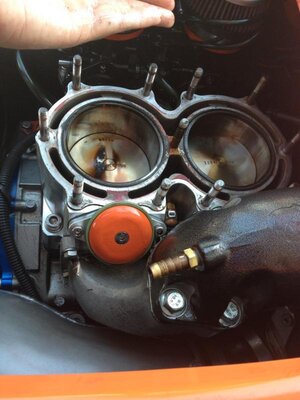

Taken a month or two before destruction. Wasn't running right. Less thrust. :):):):)ed with carb settings, all over the place. Checked the head, back piston is brand new, front has a very new char prolly from me screwing with carbs. Had a small twig stuck between pump vanes. DER. Front char eventually goes away.
