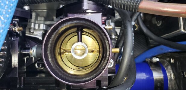

Just picked up a set of Art's 50mm carbs for my 967. They are set up for external carbs but he integrated mounting to the carbs/speed plate for clean setup. Pumps used are Mikuni DF62-702. Art recommended using dual pumps (one port on each outlet plugged). I was running a set of 46's prior and these hit much harder. My best jetting so far is a 120 main and 132.5 pilot. 2.3n/s. 115 spring (~17-18psi)20200710_182933.jpg
