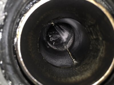

Most people run the PowerFactor systems as wet pipes it seems these days, because the inner welds are known to break after awhile, causing water to leak into the main chamber (which if you have broken several like I have, you know exactly how the machine starts to act (like carburation / rich issues, which are ever changing)). The inner / main chamber is supposed to be BONE DRY. For those who can't visualize what a broken chamber is or looks like, this is what happens:

That said, I prefer to run the PowerFactor pipe, as a true Dry Pipe (the way it was designed and mean't to be ran from the start), for the VERY strong mid and top pull. BUT, in wanting to always run that setup, it has come at a cost (to me)... I have personally ran 4 different PowerFactor chambers, of which all of them finally let go and cracked internally.
That said, and in all fairness, that happened on chambers of mine up until around 2015 (averaging one a season). In recent times, they have gone through changes in material, welding techniques, etc. The chamber I currently have running as a Dry Pipe, I bought second hand this time around and have had zero problems with it thus far.
Last summer, I broke a chamber, received a new one, and it broke within 2 rides. Fortunately, it was warrantied no questions asked. 2 riders on my lake, also purchased brand new PowerFactor systems last season, running them as Dry Pipes and did NOT have any problems with there chambers all year, and they rag on there skis harder than I do.
So my conclusion, is not all Chambers are created equal. Some break quick, some last seasons. You have to pay to play in this sport. No exhaust is perfect in my years of this sport. We rag on our machines... stuff breaks. End of story. Even though there is drama involved in keeping a solid running Dry Pipe setup, I prefer it and will deal with the Drama.
