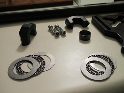

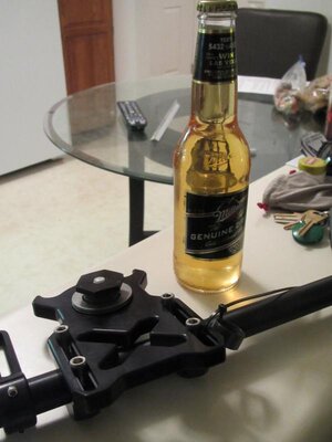

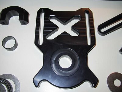

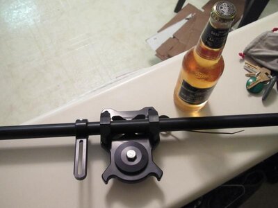

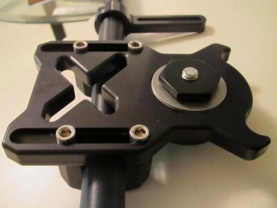

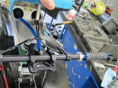

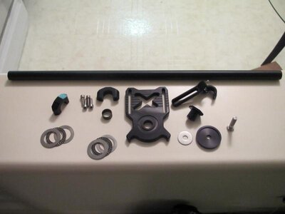

So I decided to purchase the X-Metal Adjustable steering system and here is what I found...
To start off with, everything has really close tolerances. The screws that lock the plate to the bars actually have a slight "self-clearance" effect, but retains an extremely tight lock on everything. It sort of trips you out because you feel like your are scratching that excellent anodized color when you lock it down (and you do)...

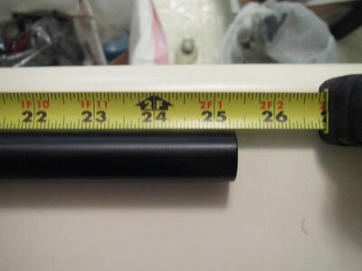

The bars are a little longer than 25" wide. I ordered the non-knurled ends so the ODI grips would slide on and off easier.

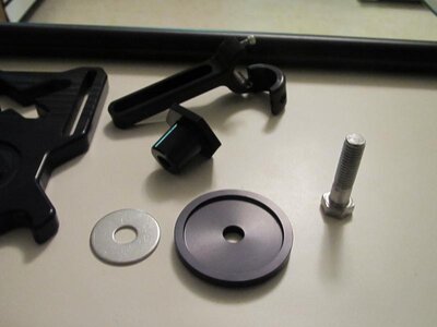

The screws that are used in this assembly are actually a mix of Metric and Regular. The plate bolts use a 5mm Allen wrench and the steering cable mount uses a 7/64" Allen wrench... Thought this was odd, I figured they would have stuck with the same style screws throughout the assembly.
X-Metal provided me with a bushing for use with their pole and a bushing for use with an 'OEM' pole. The system as a whole does NOT fit an OEM Square Nose pole without modification of the pole. The reason it doesn't work is due to the plate bolts that lock the bars down actually scraping on the pole-mount face and do not allow the needle bearings to become flush with the pole's flat surface, thus ineffective. I do not know if it would fit a stock RN or any other pole...
Overall, seems like a solid product. Could use shallower bolts on the plate to allow for more universal use with poles, but then again it makes the user lean toward dropping the cash on their handlepole.
