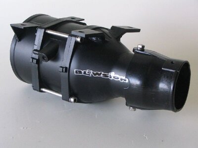

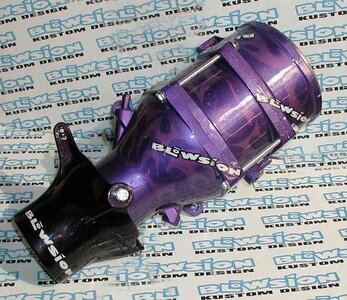

Ok, We are all on the edge of our seats about this "Drop in pump". It's a given that it works way better than any FX-1 pump. But how about a few pictures??
Is this a picture of what you guys built for Blowsion 4 years ago? :cool2:
HOLY CRAP! that is it- wonder if its still alive? :fingersx: :headbang:

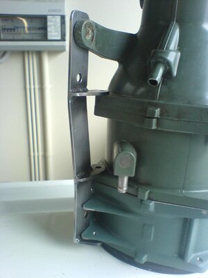

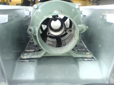

The guys name is Trevor and he builds Drag cars. I bumped into him at the anodisers. I happened to have the pumps in the car aswell as Tricky's pics. I showed them to him to see what he thought. I have been having alot of trouble finding someone to do the work. He came up with the idea of the brackets which seemed really simple. I guess I'll find out tomorrow if they work or not when I fit the pump and drive shaft. I'll be very surprised if the alignment is out after looking at what he builds.
