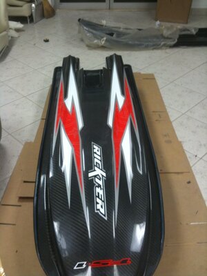

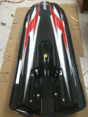

I was very impressed how the hull was built. It sounds Hard when you knock on it. I just wanted to make it super strong, so more carbon layed down. Got all the Re inforcing down, Sides are 10.5 oz Carbon T400, Bottom has a 10in by 35in heavy Carbon mat T800 & another layer of the 10.5 oz Carbon on top. Tem (Superfreak) hooked me up with this high end Carbon.
Got the Trim & reduction nozzle together. Checkout Thrust Innovations new trim ring (Little lighter) looks really cool.
Tomorrow's Plan
Going to do the pump shoe in the morning, engine mounts, & hull hardward. Trip over to Chris's house for some small parts first thing & then back to the shop to finish it.
Looking good for a Monday Ride!

Had to go back to the shop tonight & do the Pump shoe. Here's some PICS of the bottom.

Got all the motor mounts in, hull hardward is done, Turf for the tank & water box, pole bracket & pole are mounted. I layed Carbon over the caker FFH.
Now I gotta start pulling the motor & pump out of my SJ.
