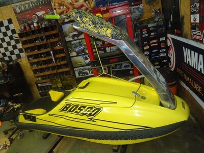

Im going to buying a bob hull this winter and building it and im wondering whats the cheapest route to go. ive been reading and it sounds like you can just buy a 1996 or newer superjet and swap everything over. could i do that with a square nose or no? and if i were to do everything from scratch does anyone have a parts list of everything id need or is there somewhere i can get that thanks.
