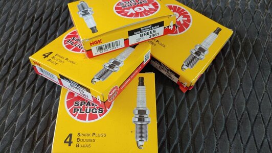

I run them in everything, but with solid tip BR8ES's hard to find are people running 7"s?
Any danger with running a tad hotter plug? I tried 9's, but they looked fouled after a few rides.

Where have you checked? Auto zone and advance stock them here. 3961 is the part number for solid tip. In a pinch BR7ES is fine. One step hotter is not a huge deal

I found some at the next town over so I'm set. All the local retailers are out around LOTO.
I even called NKG and they said they have been out since Feb and have 7,000 on back order. They have no idea when they will get more.
There are other Spark Plug Manufacturers like Champion and Bosch.
Just cross reference the NGK BR8ES and start riding!
