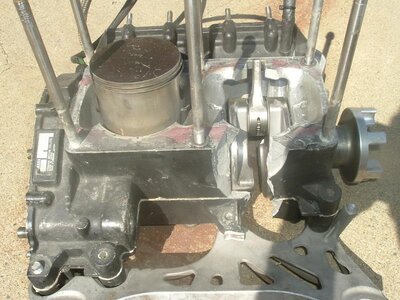

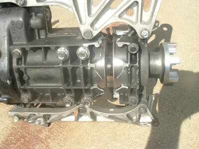

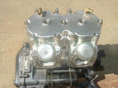

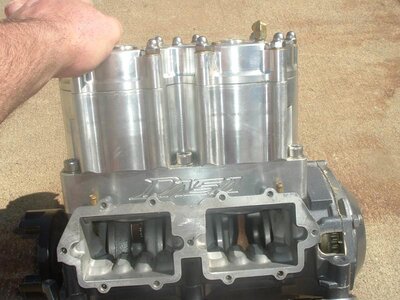

i'm sure you can figure out which dasa motor i'll be using and which one blew up on me.............DSCF3702.jpgDSCF3703.jpgDSCF3704.jpgDSCF3705.jpg this dasa 850 stock stroke was the one that was in steves green backie chan demo boat at Daytona. i just went thru it and put new seals, wrist pins and bearings. one of the wrist pins was about cut in half, so it was ready to blow up. pistons,rings and cylinders looked good. trued and welded SBT crank. str8huckin bought this motor either new or next to new, put a half season on it and went to the dasa 1000. low hours so should last until the wrist pins need replaced again.

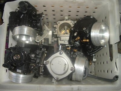

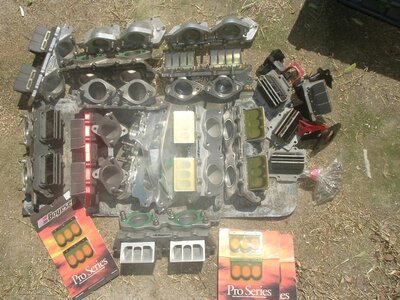

need to figure out what intake manifold and reed system i should use. why dont somebody just offer to buy this boat, give me a deposit and i'll build it with whatever parts you pick. price will depend on parts picked, as usual.DSCF3706.jpg
