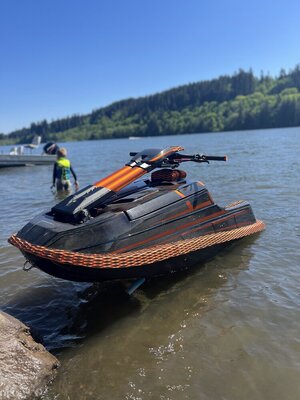

I never followed up on the cable issue. Ended up swapping the HD Blowsion cable for an OEM one and it passed right through. The Blowsion one was just too thick, I guess. But the ski has been out on the water numerous times and is running great! Definitely need to upgrade to a mag 48mm pump in the very near future though.

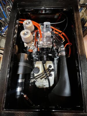

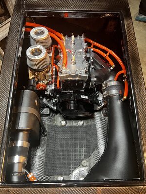

Glad to see my old ski is still looking good! Sorry for not responding earlier but Fate and I only ever use OEM cables on all our builds. Glad you got it figured out. Now get us some action shots!
