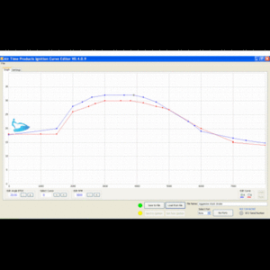

This brings us to the cut off point for maximum advance and this is a difficult one as the engine will come on pipe at different rpm depending on where the water adjusters are set on the B pipe but its usually around 4-4500rpm I would consider starting to pull the timing at 5000rpm very safe. The torque peak is again not set in concrete but around 6000rpm is common and this is where the timing should be down to around 18*. The final advance should be at about 7000rpm and a good number here seems to be 14-15*.
Hope this is not confusing, one other thing I would like to say is if you are using an engine builder and he does a curve for your particular engine then use it. If you still feel the urge to play use the B curve and fit a switch.

The reason is you do it is to increase the heat in the exhaust pipe.
The increased heat makes the pipe pull on further into the power band by way of the heat increase making the pressure wave travel faster.
When the pipe is finished making power you can put some timing back in and increase the rpm more ( this is more done on race boats)
If you have a look at the logo for my bussiness you will the timing curve I am talking about from the days when I used to sell my own jetski iginitions
