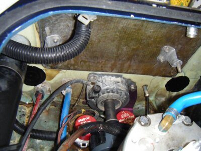

OK guys as I was cleaning up the wiring in my ski I noticed the factory foam fill holes wide open. I looked anround to find something to fill it with and this is what I came up with as a temporary fix till i reinforce the whole thing one day.

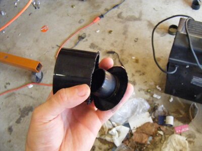

First. find two spray paint cans and jack the lids.

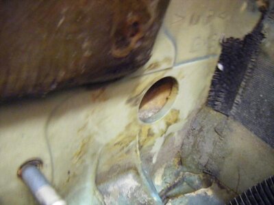

Second. Get a dremel and cut round the top till your left with what you see in pic 3. 4.
third. Take some sand paper and ruff up around the factory fill hole. Then clean it off with whatever you want. I used alchahol.

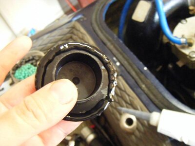

forth. apply a bead of 5200 around the edge of the cap.

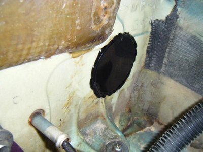

Fith. Plug dem holes. Add this to the tech section if you want i just thought i'd share what i had figured out. the caps fit pretty good in the hole prababbly about an 1/8" gap around the middle peice of the cap that sticks out and the fill hole.

looks clean, but i would just take some and fill the holes a little and smear it over the foam. easier and you don't really see down there any ways when the ebox installed.
while your in there you should take some 5200 and seal up around the cooling line tubes and the exhaust tubes.
