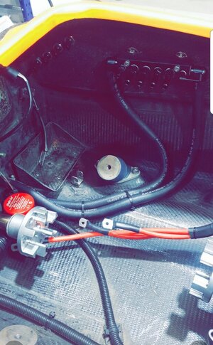

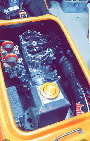

Had some time off over the Christmas break and decided this year was the year to get back into the sport. the summer i had on the havoc was plagued with tuning and mechanical issues etc. and my riding never really improved because of the limited tray time. so have gone thru the ski and doing a few upgrades as we speak.

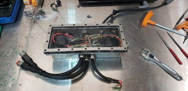

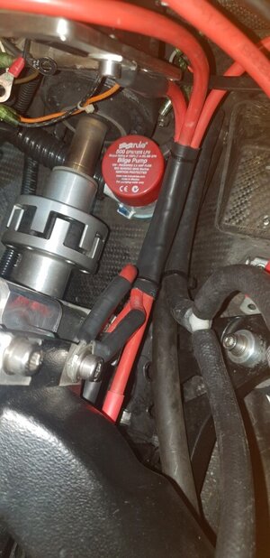

Rode it after quickly getting it going for the Christmas break. could not get the tune dialed in, leaky needle seat, killing batteries etc made for not much ride time. was managing to get 360 spins around with some decent air. Latest stage of build and doing currently - rebuild carbs, 4 gauge wiring upgrade with dual earths, new battery, new fuel tank, new waterbox, neaten ebox, domes, avgas, new timing curve, redo cooling lines maybe go to a water manifold setup. really want to get it dialed in and finally get some tray time.

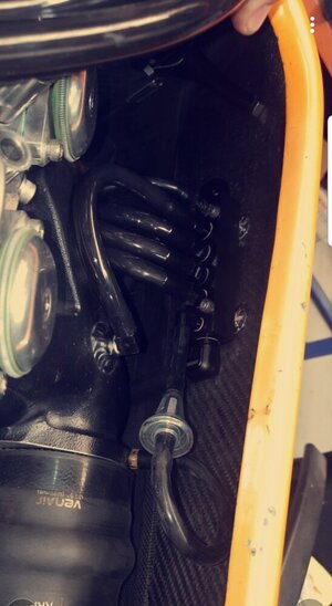

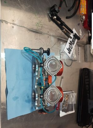

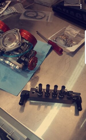

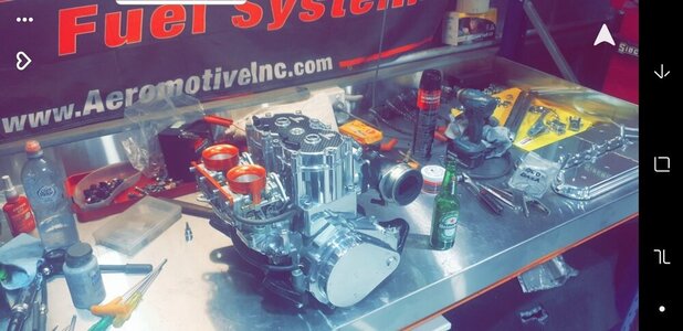

Few updates.
-Rebuilt carbs
-Added a primer

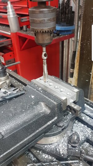

-Made a water manifold, and re routed cooling setup. Now feeding the cylinder and manifold evenly, Also added another pisser and now use all 4 outlets out of the head.

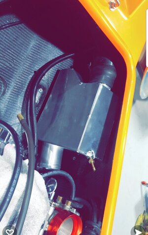

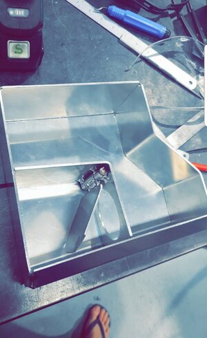

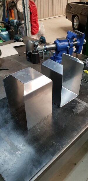

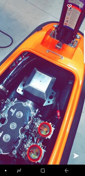

-Playing with waterboxes ideas. Have seen a few designs this ones uses an Internal flap to help stop backwash as the pipe in this hull lays really low and the rrp box as everyone knows isnt the best. Will see how it works

Is this the OG hull? I had the green one over the winter but sold it. I know of an orange hull in Florida that I thought was the og hull. Also please update on that waterbox? Really like the idea and concept of it.
