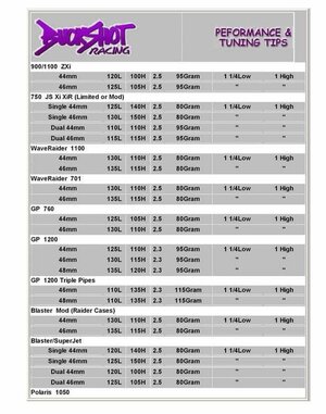

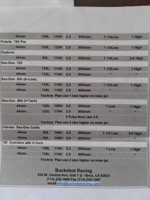

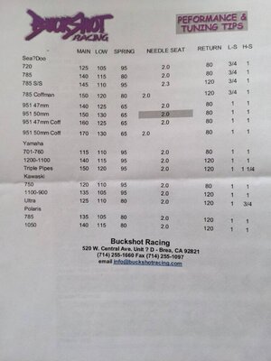

HELP tuning BLACKJACK FOR DASA 771 ?
FRIENDS, PLEASE. WHAT IS THE SETUP (SETTING) , DUAL BLACK JACK 46 CARBURETORS FOR A 771 DASA?

135 pilot 120 main and whatever seat and spring is what I'd throw at it, but it's still going to need to be test ridden and taken off multiple times to get it right. By the looks of your request with screw turns, you want somebody to arm chair perfectly tune it for you.

Have a set of BJ 48's I'm running in a small dasa.
Just guessing on a starting point would be 125 low, 135 high, and a pop off around 22. What spring you will need to get that pop off depends on your NS size, my carbs seem to like a higher pop off pressure.
