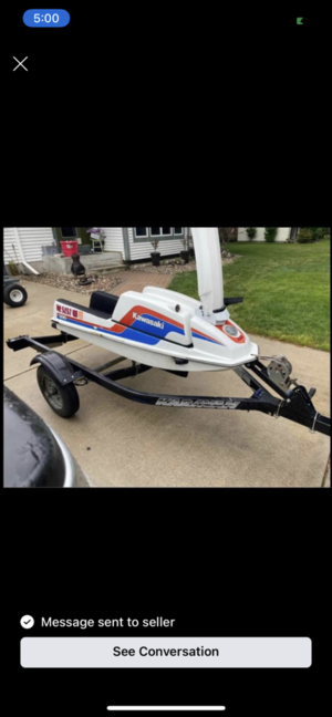

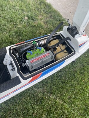

Hello all! First post here, not new at stand ups but new to swaps and heavily modifying them. I currently have a js300 with a big pin 750 swap and a 550 pump. I’m looking to pick up an sx300 hull and partial flat deck it with footholds for all of the freestyle fun. Assuming that they came with the same motors, the driveline swap should be pretty cookie cutter given that the 750 is already in a cradle that’s in a 300 hull? My js is side exit exhaust , what recommendations would be had for the exhaust in the sx hull? Thanks! I’ll have update pictures along the thread as I’m picking the hull up sometime in the next week

You might be opening up a huge can of worms.
From what I can remember the hulls are completely different. Engine mounts are different. Sx hull won't except 550 pump without modification. Exhaust exits out the rear. (From what I remember)
The 300sx hull is better than the js300 hull but transferring your driveline over won't be bolt on and go. Also the 300sx isn't a very good freestyle hull.
You might want to consider finding an EME hull set up for kawi instead
I don’t think flat decking is functional either. A widened tray with foot straps though is super functional. I think you should keep that hull because it is awesome!
Here is what I would do. First 750 big pump conversion. It will give you the bottom end hook up you need for tricks. RHAAS and Blackmarkit both make kits that bolt in and use an x2 driveline.
Second adjustable aftermarket handle pole with over pivot steering. In my opinion best modification for any jetski. Being able to personalize your pole length is a game changer. And OVP is the best thing ever.
Third widen that tray up. RSKI Riders on YouTube is about to do a video on tray widening. A bigger dance floor is always better.
At this point your ski will be a masterpiece. You already have the big power plant swapped in so you are almost there! Just my 102 cents.
Sx and Js have different pumps, driveline, bulkhead pass(sx rubber carrier bearing vs midshaft thing in js), sx is rear exhaust, and sx has rear sponsons which basically should be removed anyway. I don’t think there is any technological advantage hull wise to sx. Also I left out in my last post, Fish Stix or pro watercraft rear sponsons. So amazing literally makes it ride like modern skis. That should probably be #1 actually. And tubbies!!! Front sponsons are also a total game changer on these skis!
