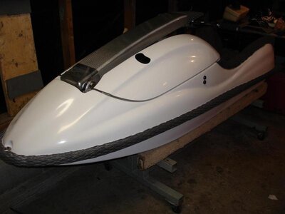

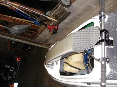

Man me and Dan just spent 14 hours of fitting and tweaking and fitting and tweaking and motor in motor out motor in motor out.....I'm out like a light......but here are some pics.
Nothings really tightened down and I have to wait for some 5200 long cure to cure so 7 days from now she is in the water.

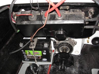

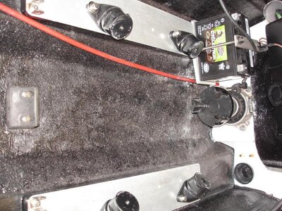

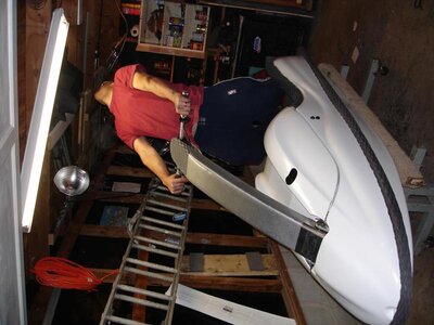

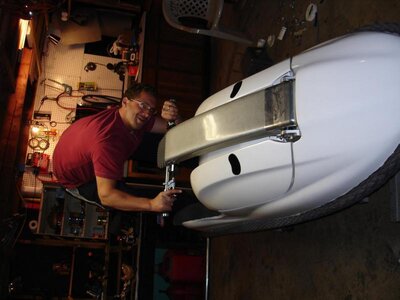

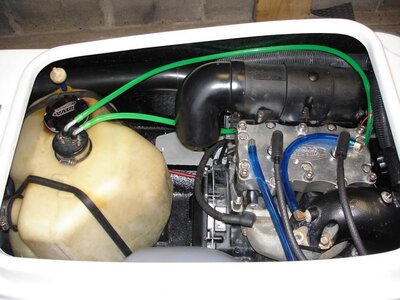

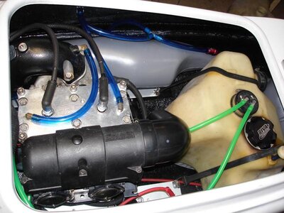

Ohio
a couple more.

Ohio
By far the most excellent thing so far about this set up is that I can take my head pipe, coupler, and chamber all out together..ATTACHED!!!
And the head pipe feeds the stinger so I don't even have to remove a hose clamp. Just 3 head pipe bolts and the whole dang thing comes out!!!!!!!!!!!!!:djsmilie::djsmilie::djsmilie: :Banane25:

how well did the drive line line up.
did you need to do a lot of shimming etc?
Pump lined up PERFECT with .125 shims.
It is ready to rip pending some 5200 curing and me taking everything back out again and re installing everything with never seize and loc tite.
Man I know that motor only weighs 85lbs but my back is killin me.:no:
I would say the hardest parts were mounting the Ebox (Thanks Doobie) and making the intake grate longer (Thanks Surfer smurf).
The rest is just constant fit and check.
